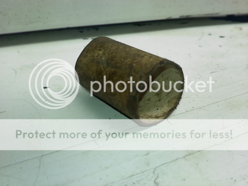

When I had it back together I found a short cardboard/paper tube on the bench that looks like it could fit on the shift rod.
Any ideas?
If it's cardboard or paper it doesn't go inside the t-case. Just sayin'.

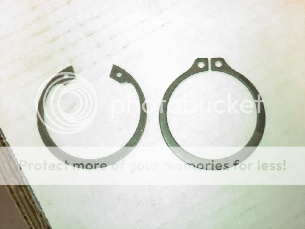

Can I use either one of these styles in the transfercase? The stock style dosent have snap ring holes and are a major pain.
The ones Im asking about go on both sides of the plastic speedo gear
Any idea what size they are?

Heres the cardboard tube I found

You are welcome and that tube is packing/trash. The plastic speedo drive gear was in it.
They are lock rings, and they require a special tool for easy removal + installation, a pair of Lock Ring Pliers:

I used the one on the right, worked perfect and easy
