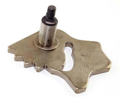

$24.95 At summit racing. Thanks for the info in this thread. I will be flat towing worry free
Do you have a part number or name for this at Summit Racing. I can't find it anywhere on there website.
Thanks
Brand Omix-Ada
Manufacturer's Part Number 18676.32
Part Type
Product Line
Summit Racing Part Number OMX-1867632
UPC 804314030582

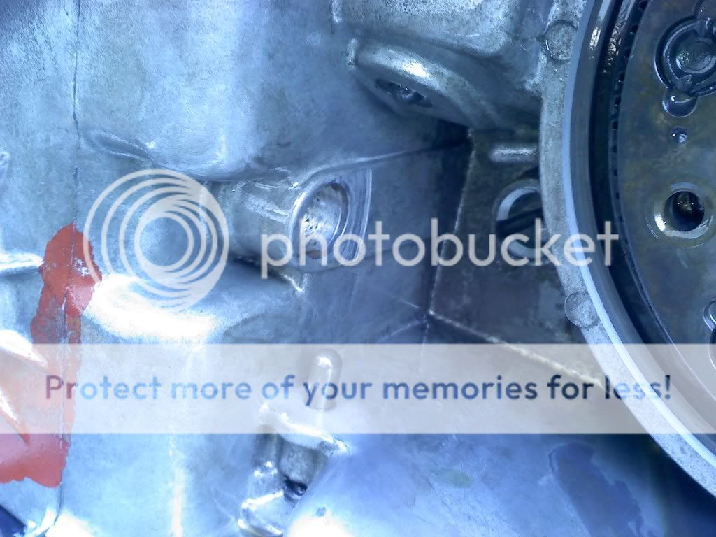

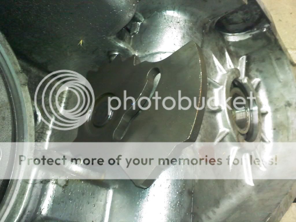

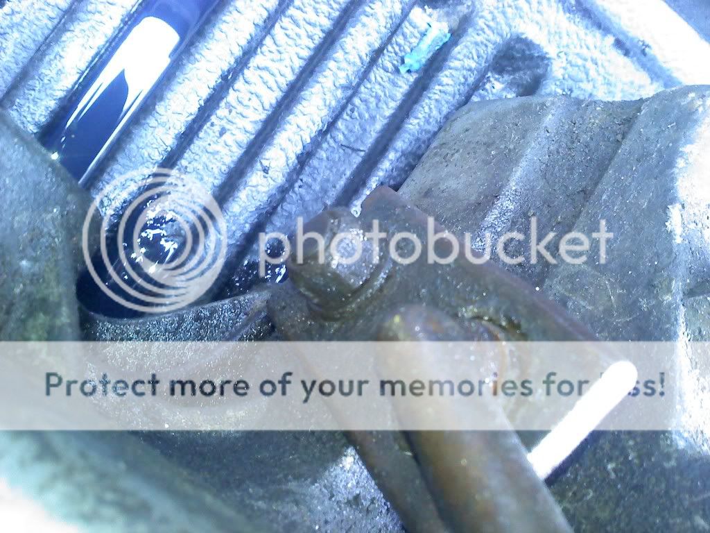

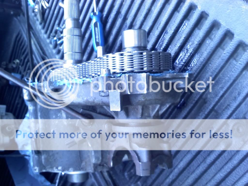

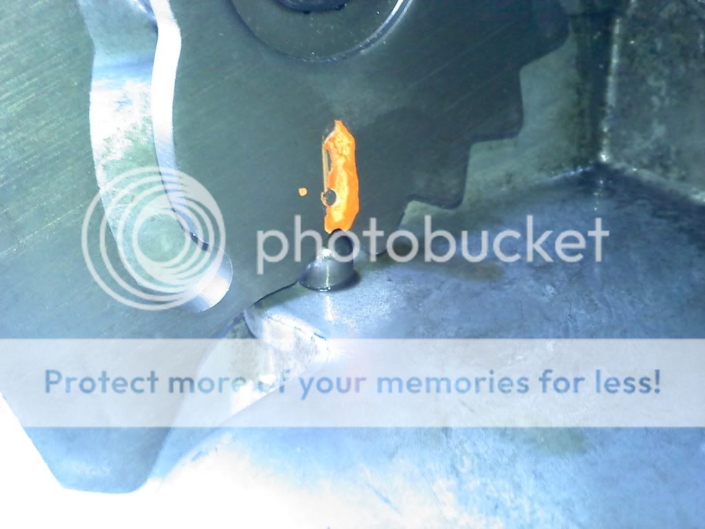

What a night.
Installed the new plate
Got to watch that pin or it will shoot out and be gone forever.
This part makes me nervous
This is where the plate goes
This nut needs screw loose first
Reassemble
So,,,
I rtv the other half of the cover on and the shifting dosent work. guess who forgot to install the return spring.
Put the case back together and Im pretty sure its ok.
I can turn both yokes if opposite or the same directions from each other when in neutral and the input shaft to the tranny dosent spin.
I can also spin the front yoke and the rear yoke almost dosent spin. Just the friction is barely making it move.
Im thinking I got it
My 2.5 to 4.3 swap thread
