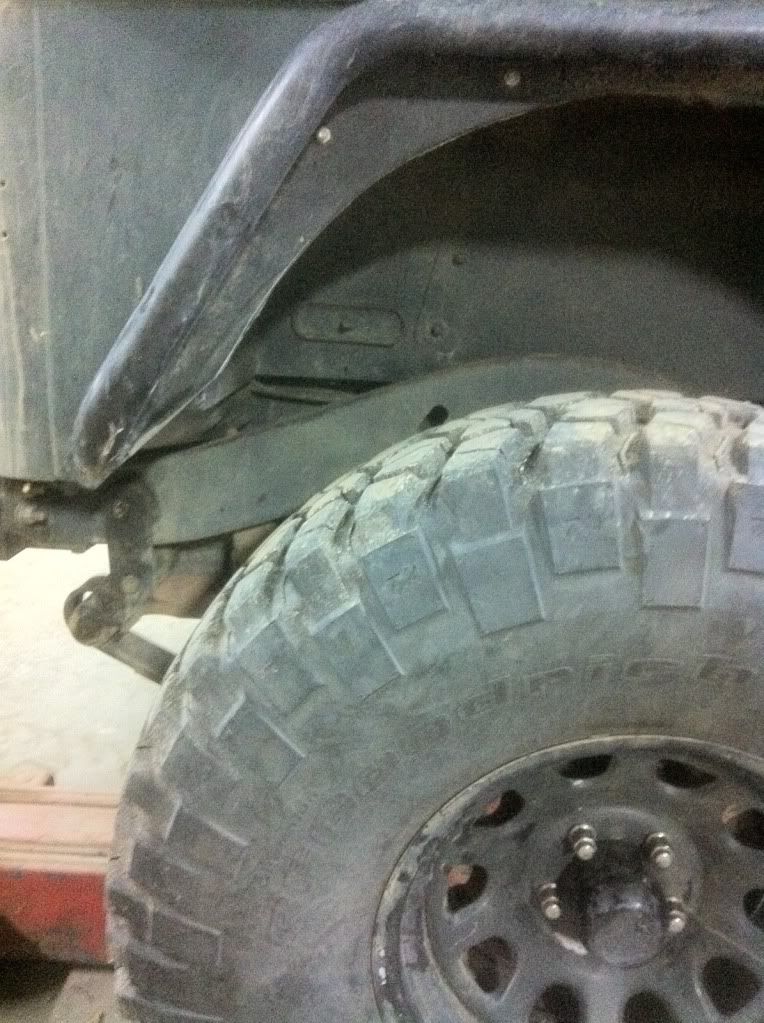

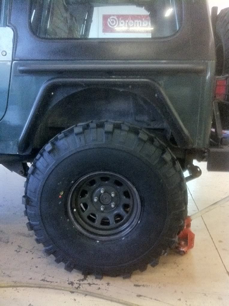

Originally I left the liner intact but the larger opening made it harder to keep mud from building up and trapping moisture in my fender wells. I ripped the liner and sprayed some rustoleum rattlecan undercoating.
Before (only pic I have that shows the hole)
After:
