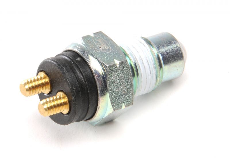

http://www.quadratec.com/products/52156_0005.htm

Mine has less threads than that one and more of a longer shaft

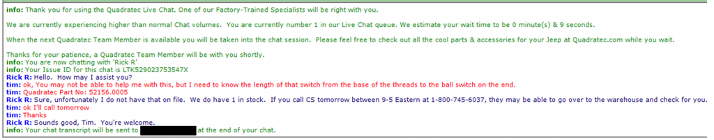

Chatted with Quad:
Maybe call them tomorrow and see if they can run and check?
EDIT: Does your transmission have a tag on it that has the model information? Usually a metal tag on the body of the transmission itself?

Based upon it being a Jeep with that style switch, If it's a 5-speed manual than I believe it's a T5. or if its a Four-speed- T4.
Call Quad and plead with them to do some legwork for you. You may be able to send them that image of your part next to the ruler. After that, I'm at a loss. PM Que here maybe he has one lying around..

I have both switches installed on my '90/'93 2.5L AX5
I swapped my '90 drive train and wiring over to a '93. The tranny in the '90 had the 2-stud style switch that you have, the '93 tranny had the 2-wire switch. I really don't remember why but I ended up putting the 2-stud into the same hole you show the 2-wire mounted in your 1st set of pics. I figured out that my (new) '93 wiring was set up for the 2-wire switch and I installed it in the next hole forward (at the same level) of where you have yours mounted. Works like a champ.

Move the switch to the hole that I circled.
