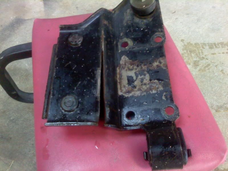

I really need to get one to. Mine is cracked up tha middle.

That's exactly what I need. The torque arm plate. I found one about 2 1/2 hours away. I'm going to pick it up in the AM.
Omohundro: if you know anyone that can weld well, I'd just have it welded. They are extremely hard to find.
Mine was for a 4cyl, I'm in the middle of doing a complete drivetrain swap from a cherokee. 4 cyl plates do not match.

Just bevel the crack with a grinder and weld it with a 7018 rod the weld will flex before it cracks again, put a root pass, grind and a second pass overlapping both sides, it'll be stronger than a new one....ask me how i know....or just take it to anybody who knows how to weld, easy fix.

I would definately just weld it up if I had one that was cracked but I need one for a 6cyl not a 4cyl. Looks like I'm riding my motorcycle 2 hours away to pick one up.
