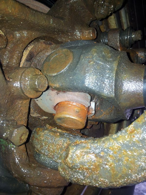

My non greased ujoint
Oops ..
I'm new

What the heck is going on down there Rotten?
Gozz is offline
post #83 of 94 Old 02-05-2013, 01:15 AM
ROTTEN
Location: SGF
Posts: 768
That's was my xj's blown u joint.
I knew the joint was not great and needed replacement but I got focused on the yj. Well 2 years later it seized up broke and c clip came off and snapped the ear.
Maybe if I had greasables or just replaced it I wouldn't have been out $225
So grease them buggers!
