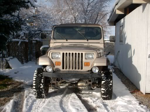

I put my trans cooler between the grill and the condenser, I have the Auto and A/C in my '94:
Kind of a bad pic, but it's really the only one I have of the front end.
