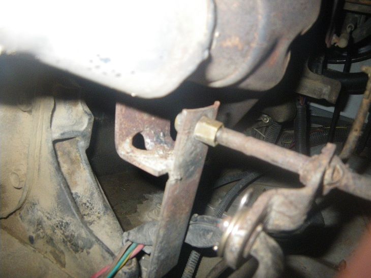

I am doing a 4.2 swap to 4.0. got the trans and t-case in last night and today when putting in my exhaust manifold i realized that it is hitting my shifter bracket. doing some research i saw the bracket is different on some other models.
my question is i could just cut the bracket to resemble that of the other ones right? i would also reinforce it a little since it would only be held on by one bolt now instead of 3.
or do they sell a bracket somewhere because i like that idea better?

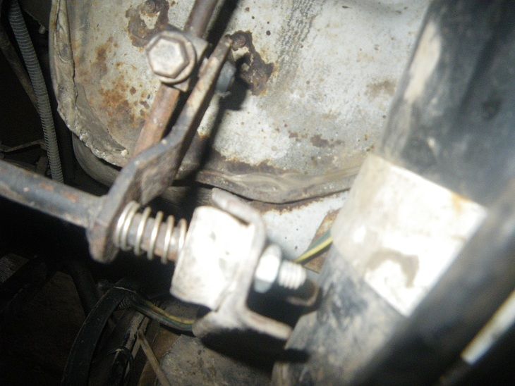

photos attached with the blue mani are mine and the older looking ones are from a 91 4.0 also with the tf999 credit to The_Goob

I had to re make that bracket when I put on a borla header. A few mock up pieces with tin and a couple quick cuts and welds. The only issue I had was the exhaust was close enough afterward to melt the plastic bushing so I ended up with a brass pipe fitting and a spring to hold it in. Can't find pictures.

Your bracket looks just like the one on my '89. To make the Borla fit I cut the ears off rewelded them on the other side, shortened the arm that mounts to the trans, and re-drilled the rod hole as close to the 90 degree bend as i could.

hard as i look i cant find any pics of the modified bracket. I did find a pic of the bracket from my buddies cj7. I thought it might help when i was doing mine.
