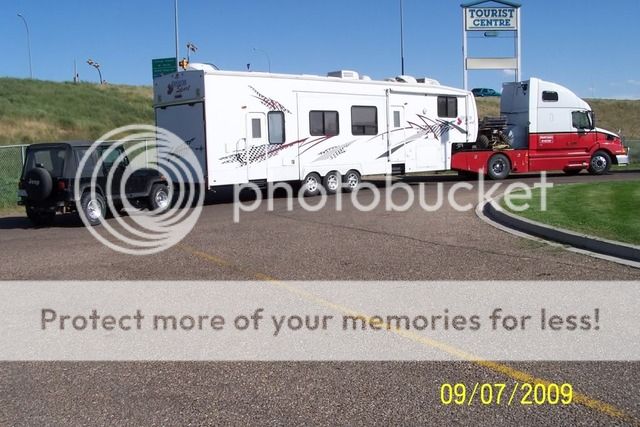

Yup, thats the way. I flat tow mine auto trans in park TC in nutral, probably 15,000 miles or more towed now
