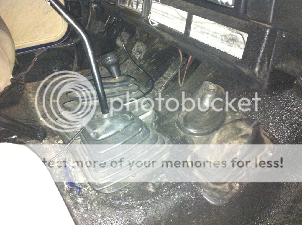

Had a issue with shifter boot earlier. Kept me from shifting into 2nd 4th and reverse. Pulled that b**** off and it shifted fine. Is the boot a 2 part piece? Like a inner and outer boot? I'll try to post a pic in a bit.

Just went out and snapped a quick pic. The thin boot setting off to the side, that is what I'm wondering about.

post #123 of 209 Old 02-24-2013, 09:47 PM
pete1991YJ
Join Date: Mar 2012
Location: Niagara Falls
Posts: 1,876
Yeah there's an inner and an outer. Its common for them to be stiff in the winter. I prefer to leave them both in to cut down on the noise and places that could rust. I use both of them and just let it warm up a bit more when its below freezing. Then when I start out I go easy on it until the oil warms up. Once or 2x thru all the gears is usually enough, a mile or 2 basically.

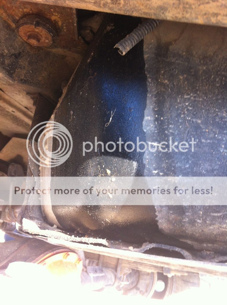

I got a leak when I fill up. It's on drivers side any ideas before I drop tank?

post #127 of 209 Old 03-08-2013, 04:40 PM
XJ93
Location: Michigan
Posts: 1,540
I would imagine your filler hose is the issue if it only leaks when you fill up.
XJ93 is offline
post #128 of 209 Old 03-08-2013, 04:44 PM
pete1991YJ
Join Date: Mar 2012
Posts: 1,876
The vent hose on that side of the tank is a bear to put on and off, it probably popped off.
The other possibility is the filler and filler vent hoses, the clamps could have rotted off.
Or the lines are just old and cracked. They're a common item.
Basically drop the tank and check all the hose connections and hose ends. The tank vents are on top, one on each side. Get a few feet of 5/16 hose and make your life a bunch easier by putting longer hoses. They go into plastic tee fittings that will be obvious when you drop it.
There are 4 bolts along the rear of the tank skid, these are 5/16-18 Its easier to drop the rear of the tank first. A 1/2" socket and extension is all you need. On the front of the tank, same size but you will need a 1/2" box wrench to catch the nuts on top. Be sure to soak everything down real good in penetrating oil before you begin.
The easy way to deal with the filler hoses is to unscrew the filler neck up top and let the tank down as far as it will go. Its just a half-dozen sheetmetal screws that ring around the filler down inside the plastic cup. The filler *will* hang up on the springs and be a bear. Thats OK, its down halfway so you can reach the hose clamps and just take the whole filler off as an assembly At that point yuou should be able to jostle the tank down all the way onto the ground.
The lines are long enough to let it sit on the ground and the jeep will still start and run off it.
Hope that helps!
(I can usually have my tank out and back in within an hour, it took practice...)

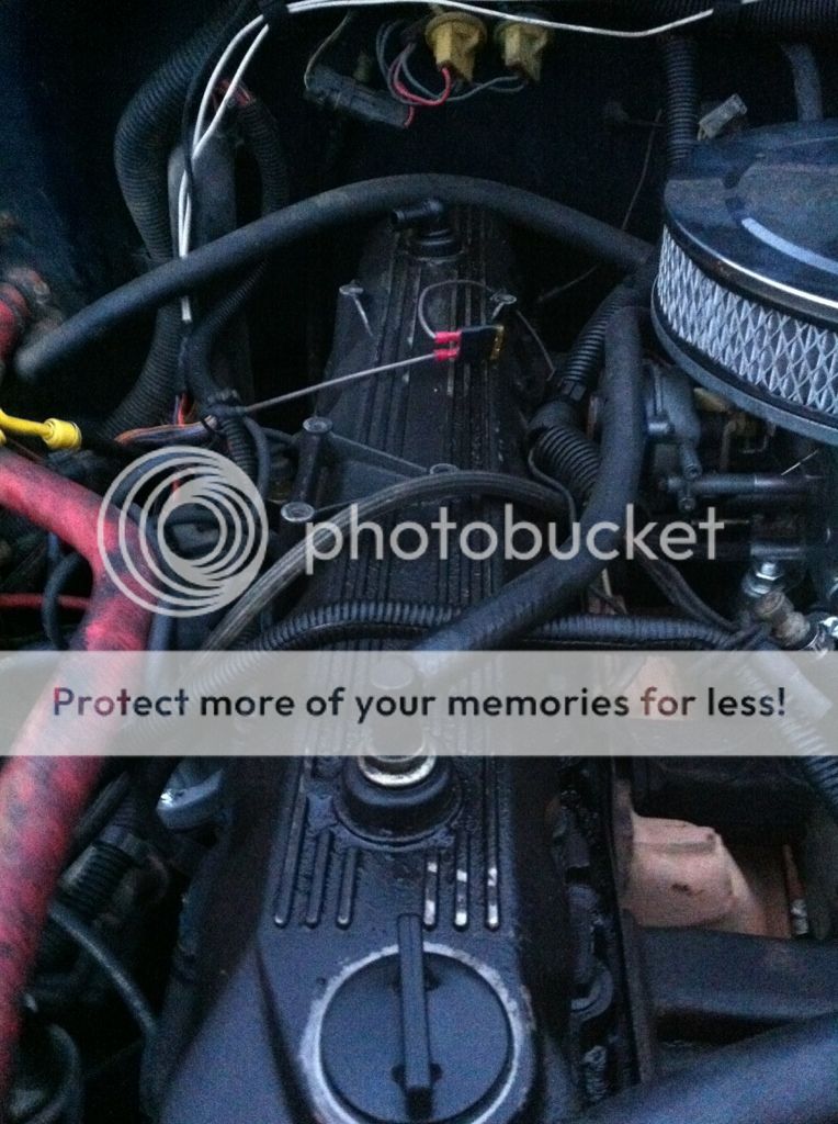

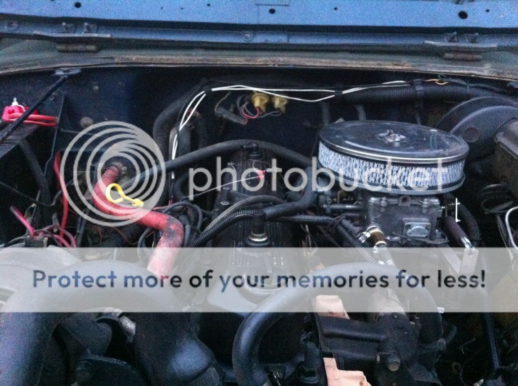

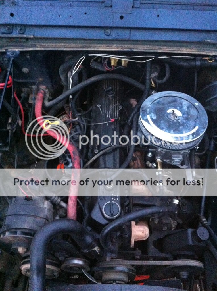

Well I didn't mess with tank today I have another problem.
Left work this morning 8:30 headin home I noticed oil pressure fluctuated drastically dropped down to around 15 psi, I had a smell of burnt oil in the cab. Then I noticed a foggy haze in the cab as well. I watched my guages never got hot never over 190-195 degrees. The outside temp was close to 50 degrees. Warmest day this winter in my area was today 62 degrees.
So I drove on home, opened hood. I noticed some oil blow by, I've noticed small spots here and there since the mc2100 swap. Now let me get to point, I've attached some pics. Were should I hook up vents on valve cover, sorry if that sounds like a dumb question.
vdubbles24 is offline

post #135 of 209 Old 03-09-2013, 06:59 PM
pete1991YJ
Join Date: Mar 2012
Posts: 1,876
Looks like you have a PCV in the front. That should go to a source of manifold vacuum. The rear line is the vent/breather. Give it some filtered air from the base of the air cleaner, if it has a fitting. Itherwise find a small aftermarket filter for that hole.
Generally when jeeps blow oil like that, its because the vac lines and PCV is clogged or leaking or somehow screwed. And they are notorious for clogging. Cleanliness and hose clamps are your friends.
