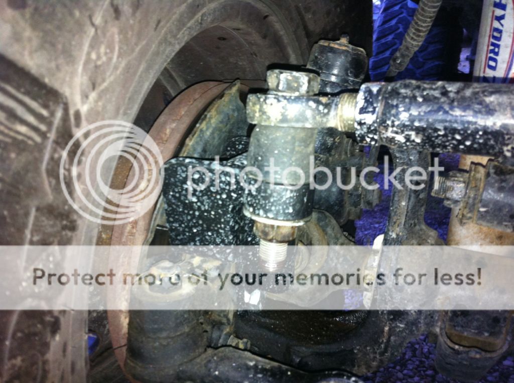

Jb kit installed, how's it look? Drove it about 15 miles. WOW what a difference. Made new drag link as well. Heading to alignment shop Monday morning.
Does it look safer, better?
Ordered new carb today. Should be here 14th or 15th MC dude off eBay. I've heard nothing but good about them so I'll give it a shot.

Save yourself some money and skip the alignment shop. The only thing adjustable on the whole front end is, the toe-in. It should be about 1/8" and you can set that with a monkey wrench. Turn in your tie-rod end (under the springs) a few turns and thats it. The steering box also has an adjustment for the gear slop, its on top of the steering box with a jam nut. All of the other adjustments that you would have on a normal car, are welded solid and forged right into the axle ends..
That front end looks *much* better with the JB kit. That's the way it should be! Hooray!
