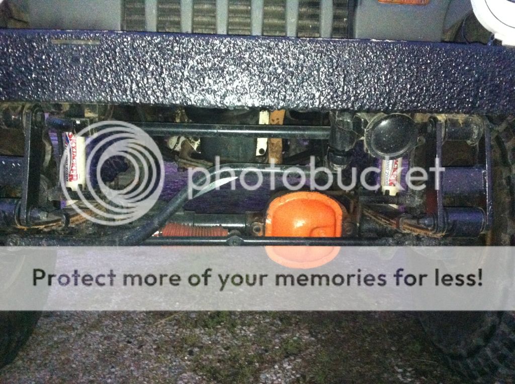

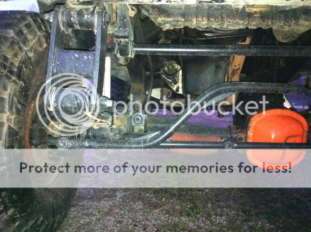

Maybe these will help.
So from what I've gathered the raised portion I'm missing is the right side only.
So the bracket and drag bar I should be good to go. The drag bar in pic is awful clean. I mean weld wise with gussets and all. Has me wondering if it was home made or not.
Thanks
Brandon

looks like trackbars are missing, that and the stupid steering link bent like that combined with those bigass tires is your steering wander

I ordered steering kit from jb4x4, guess I'm gonna go with carb from autozone. It's $29?.. Plus tax. I can't get it to idle for nothin. I worked on it ALL day yesterday. I'm gonna trash the "Z" bar in pic and build my own. I'm figurin this Jeep stuff out slowly.

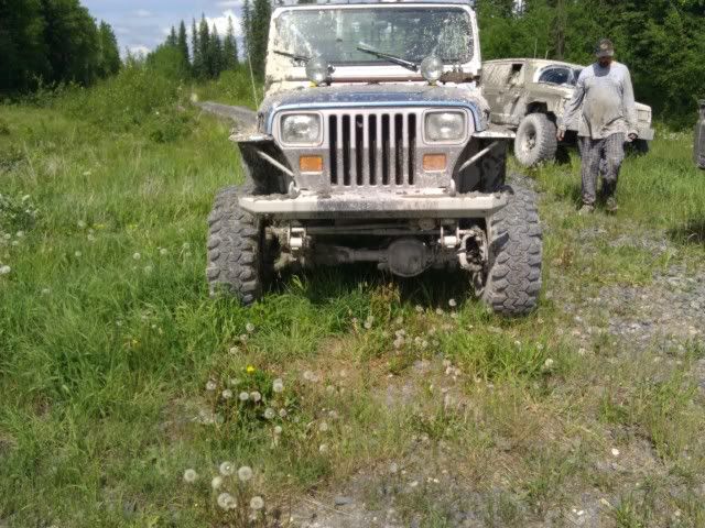

anyhow, my reasoning for the rocky road kit I used was 2 things.... it was bolt on, altho I did weld it at the knuckle... and it moves everything OVER the springs.... the Jb does not, altho both use TRE, which is nice...
bolted on in an afternoon by myself
u can see the diff from the JB, in the pics above and the RR, mine..... mine is completely above the springs, the JB is not....no a huge deal, but lots of stumps and crap where I am, seen a few guys bend them is all, figured higher is better.... no??
