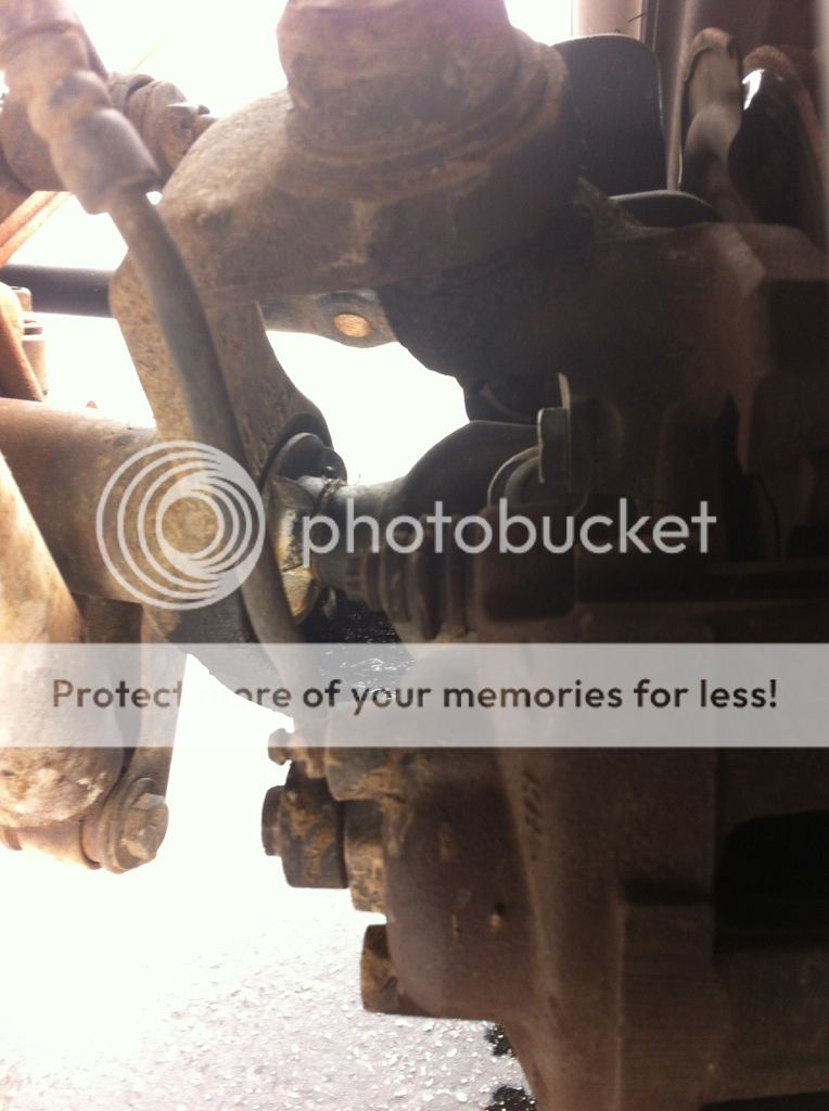

Springs, SYE, 8.8 on hold for a bit. Just spent $3500 on new central air unit! Ouch.
I have sprung a leak, I think it's axle. Any suggestions?

Looks fluid like brakes? Of course i am not there to see it in person!

I checked brakes. No leaks. It looks like it's coming from axle.

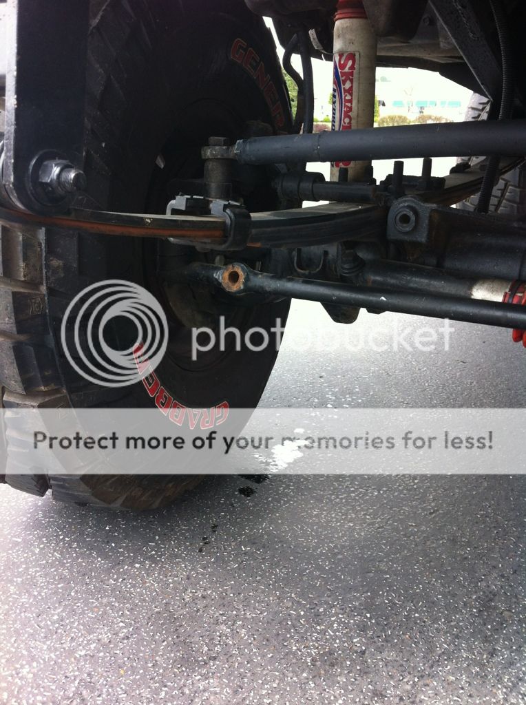

Maybe this will help.

likely axle tube seals. About $5 each. Is the leaking fluid fairly thick and does it have a yellowish tint?
With those pics, it definitely looks like an axle seal leak.
