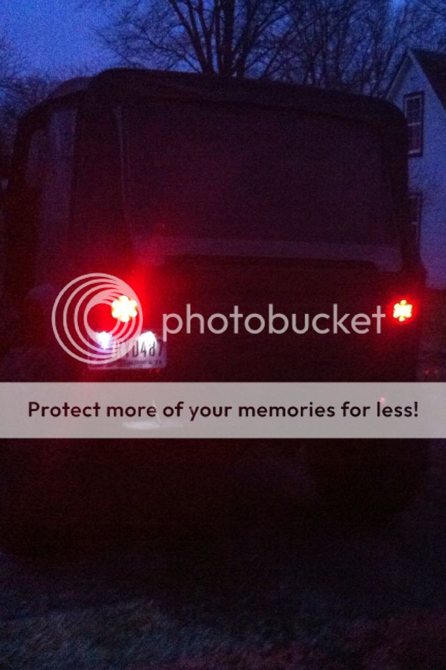

Picked up LED plate bolts at autozone. Now I'm legal. Found some 2 1/4 side marker lights "red" for rear. That be next.
