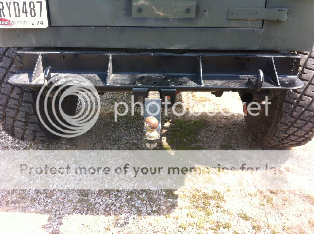

Been a busy morning.
Got hitch installed.
Got started on console. Tonight I'm gonna cut angle and make frame for it to bolt to in jeep.

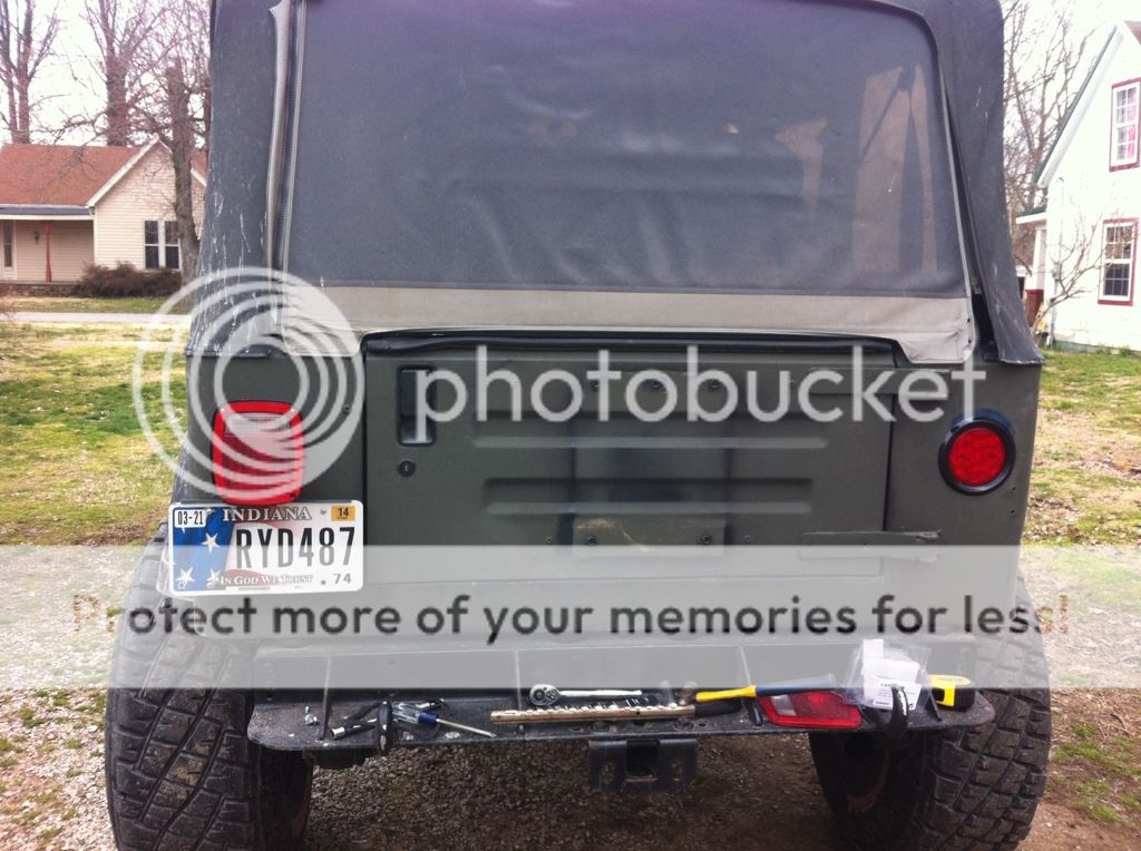

Got around to doin the taillight swap today
$34 for lights
$45 for hole saw!
Sucks to pay $45 for a saw for 2 holes.

Stock relay wouldn't allow the signals to work, replaced it with electronic relay and still nothing. Any suggestions please!!
I've done some searching with no results.
vdubbles24 is offline
post #180 of 209 Old 03-30-2013, 07:32 AM
XJ93
Location: Michigan
Posts: 1,540
You need to have an LED flasher relay, the LEDs don't draw enough to allow a normal flasher to work. Alternatively you could wire in an 1156 bulb somewhere and that would draw enough to make them flash. Personally I would just go to the parts store and get an LED flasher, they may have to order it depending on where you go.
