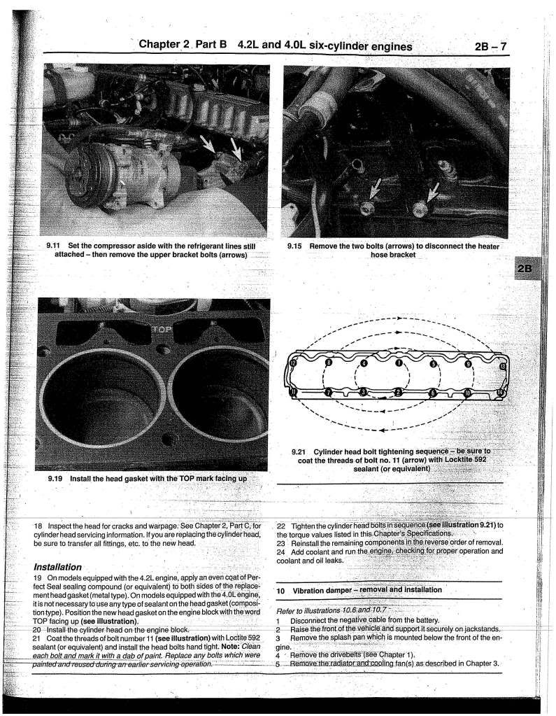

Torque specs are: 22lbs, then 45 lbs, repeat 45 lbs, then bolt # 11 is 100 lbs and the rest are 110 lbs. I will get a diagram for you in a couple of minutes.
OK, here you go.

So do you only torque the 4.2L to 85 ft lbs and disregard the steps? if not why is it worded like that.

And they are not torque to yield bolts, so they are reusable.
