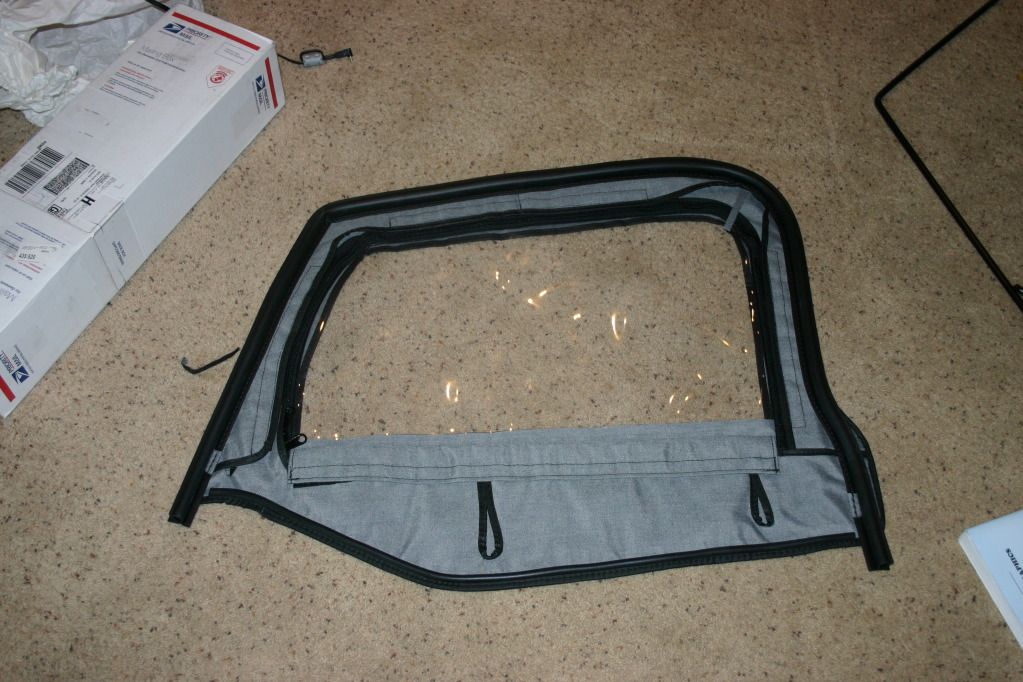

so i got a hard top from a friend in return for a stereo set up but my full steel doors are total **** and they arent even for a wrangler... but i did have a set of half doors so i decided to get some tj uppers and see how i can make it work
here are the upper tj frames from Rampage. ive had issues with their quality stuff in the past but these seem really sturdy, and i dont feel bad cutting them up
and here are the upper windows from smittybuilt (also kind of cheap since i didnt know if this would work) if i end up loving the tj uppers i may buy nicer parts in the future but for now these work
and here is one mounted. they are EXTREMELY tight to get on but thats standard and now i know they wont flap.
you can also see that they they don't sit all the way down on the doors due to the final pin not lining up
here you can see the position of the last pin verses the other pins
and here is how well the tj upper fits in the hard top opening. i did un bolt my hard top and push it back as far as i could then i bolted it back in to make room
Originally Posted by Ripper3494 View Post
ok so here goes the modification, unfortunately i wasn't able to finish tonight because the welder is buried in the other garage since the we are re doing the shop
so first you have to cut the furthest pin back off before the 90 degree bend
and this is how it will be welded back on so that the upper sits correctly
but even without that back pin you can see that it sits nicely in there
this is the only spot that has a gap which is due to the lack of a rear pin
i drove it around anyway though and the doors work great, they are totally silent and dont flap at all. also i cant feel any air coming from anywhere
this is deff near the top of my favorite cheap mod list
