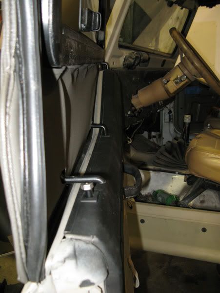

Heres the history.. I had a hard top with full steel doors when I got my jeep. Sold the hard top but kept the doors and I am using them with my supertop. I also have an extra soft top so this is what I am using when wheelin so I don't ruin my good top. I dont want to risk wrecking my full steel doors offroad so I got a set of hard lowers.
Okay so I picked up a set of hard half doors from an 87 out of a the junkyard a while back. I read somewhere that TJ uppers will fit with a little modification to the 3rd pin. I just got a great deal on a set of TJ soft uppers. Test fit them on my lowers and they fit all except the 3rd pin. Does anyone have pics of this mod to the TJ uppers. I know what needs to be done but would like a pic if someone has it. Thanks.

I've done it. just cut and weld, no pic needed, but there is one in my build thread somewhere.

Just cut a hole and put in a new pin. You can even put in a 4th one so that you can still use YJ and TJ and not have an awkward hole.

It's easier to just cut the pin off of the upper door and then reweld it farther out.
like so, only with a weld and not a nut just sitting there. you get the idea.

Did you use the same rail to fasten it on the outside? Or did you have to install the TJ rail to hold the outside flap down?
Thanks...
BTW, that is an excellent picture for showing how to modify it...

The TJs don't use a rail on the oustide, the upper door just sits on the lower door and seals with a weather strip. I just removed the YJ rail.

I did this just yesterday. I cut the third pin and took about 3/4" out and re-welded it back. I need to make some small adjustments but the TJ uppers fit really well.

Exactly, just did this to fit my hardtop on with my stock half doors/tj uppers. worked great. Just grind,measure,weld and you're good to go! here are some pics, Pictures by hallway94yj - Photobucket
