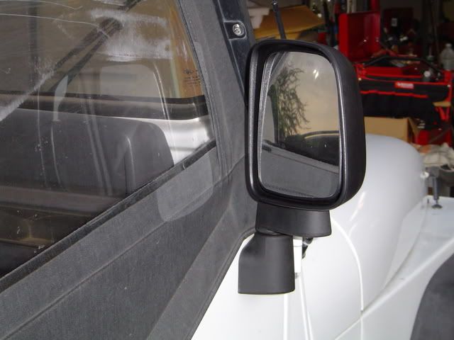

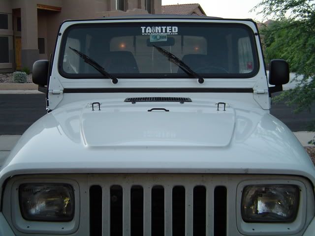

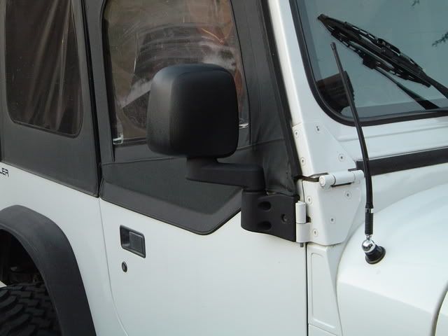

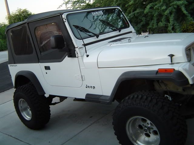

Several threads on the subject. The question of weather they fit was resolved. Everyone asks to see pictures including myself before I added them. None of the previous threads had any pictures posted so I thought i'd throw these out here for anyone else thinking of swapping to the TJ mirrors.
I only wish i had gotten these sooner. My sanity is now restored as I can drive down the freeway without my mirrors tilting down from the wind. I highly recommend these.
The stealership and some of the online stores are pretty expensive IMO. I purchased mine on ebay for $25 each. Ended up being about $75 total with shipping.

Originally Posted by johnboy68 View Post
What year TJ did the come from? I got a set from a friend that were off his 97 TJ that are just like my 95 YJ just in much better condition.
'03 to '06 models

A lot of the YJ full metal doors came with the small mirrors and so they would not fit those doors without some drilling and tapping. Some of the newer full metal doors on the YJ's (95' if not 94' also) came with these standard sized mirrors and they will fit on those no problem.

Like Leans said you'd have to drill and tap the full doors, that's what I did....
