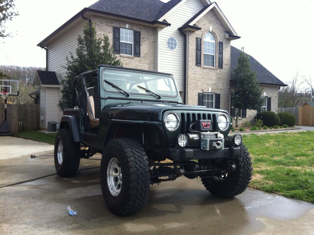

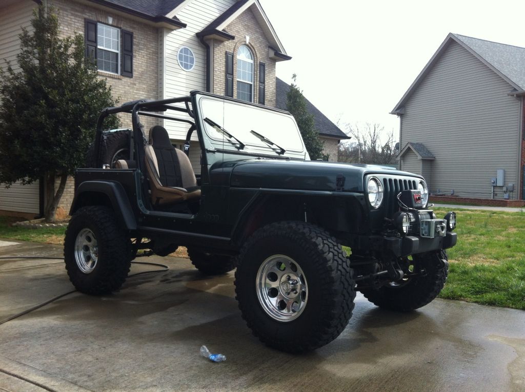

I also did a Tj griil with Yj hood.

Why J that's a good looking yj. What are the specs on it? Any more pics?
Thank you!
build thread:
http://www.jeepforum.com/forum/f12/p...d-wife-747535/
lots of pics. Just put some more up!
