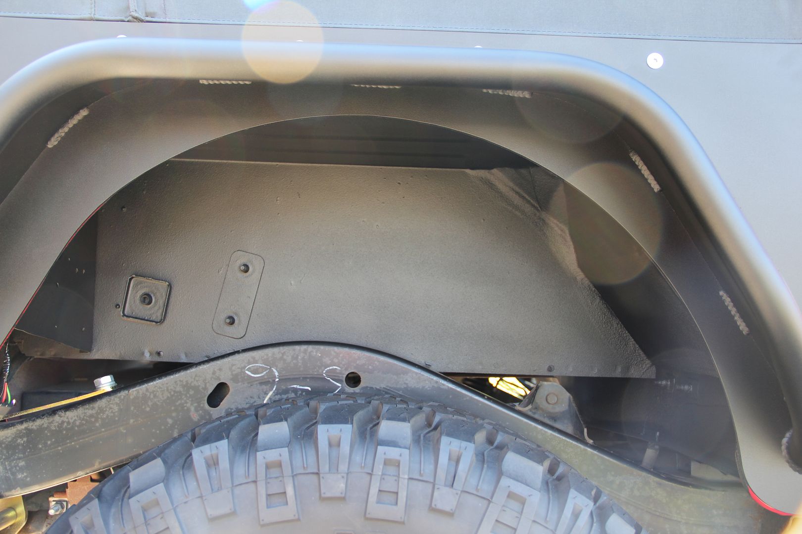

I do agree with sparrows about that metal piece. I cut it to be above the fender lip as it definitely would have hit it and the point for doing the TJ flare for me was going to 35's. I did armor with a TJ cut but same principal, so hope you don't mind me posting this.
Metal cut out that Sparrow was talking about.

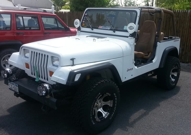

I wussed out and decided not to cut my tub when I did mine. Actually I have yj flares in the back and tj's in the front.
I got clear grill markers now. I like the tj flares.
Did you do it for cosmetic reasons or for clearance?
I'm thinking of just using the TJ rear flares, since it seems to be much tighter than the front. Was thinking that I wouldn't mess with the front at all (leave on the stock YJ front flares), but maybe I'm missing something.

Cosmetic.

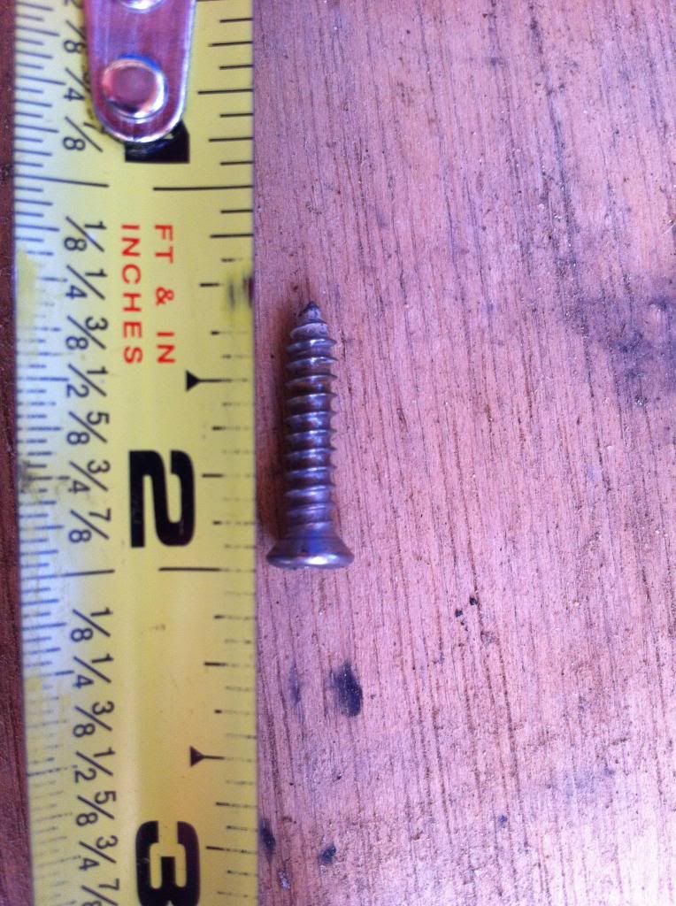

Originally Posted by Dake
I just took my TJ flairs off after running them 10 years. I put TAG YJ flairs on and looking for the screw for the marker light. Can you post a pick? As for the rust I rattle canned the cut edges and holes and had no rust at all. Good job on the flairs bye the way.
The YJ marker screw

The YJ marker screw
Sent by my pretentious iPhone.
Thanks about how long is that? 1.5 in
here' ya go. looks like 3/4" or so..
