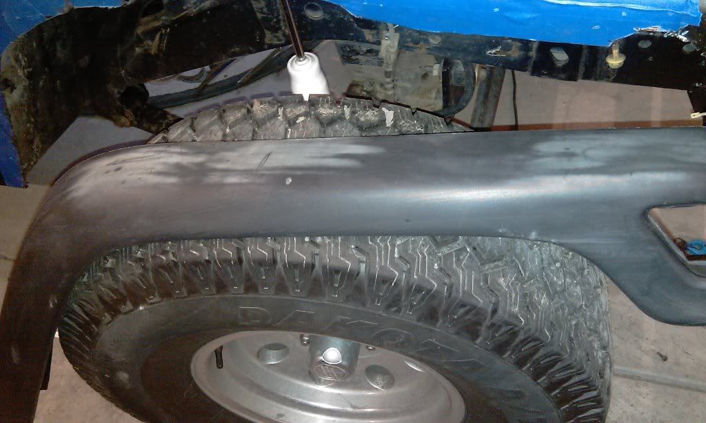

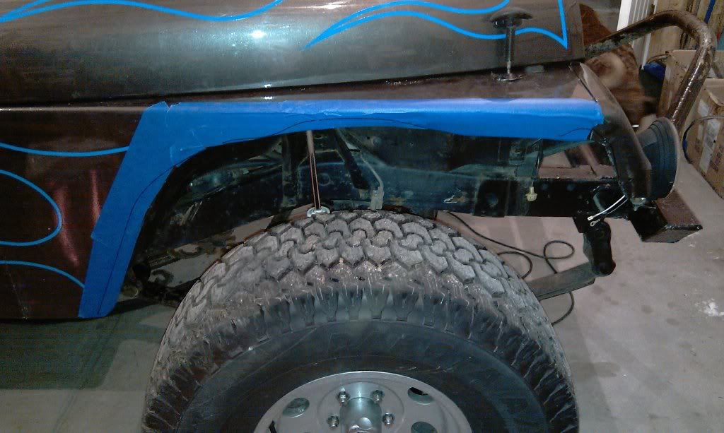

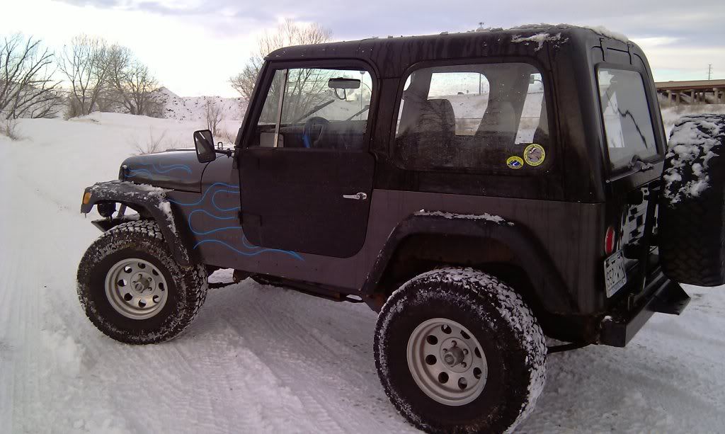

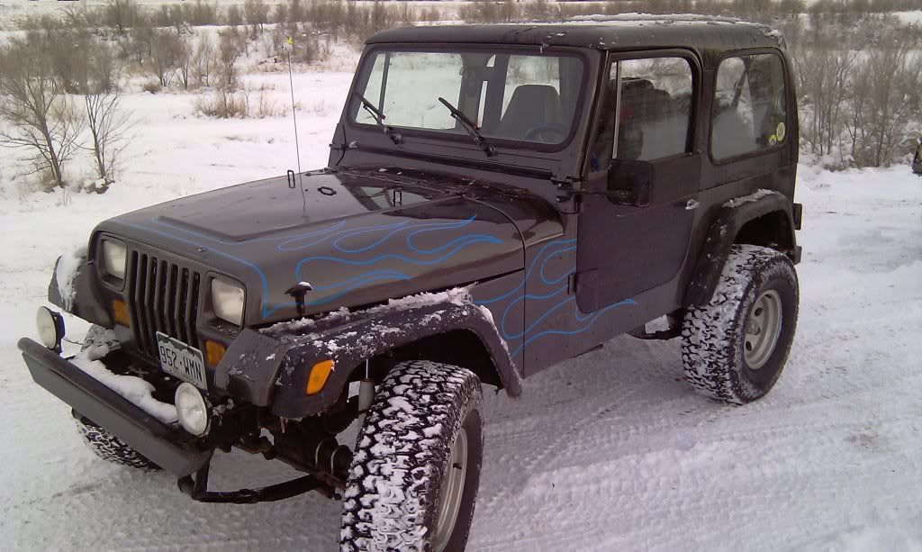

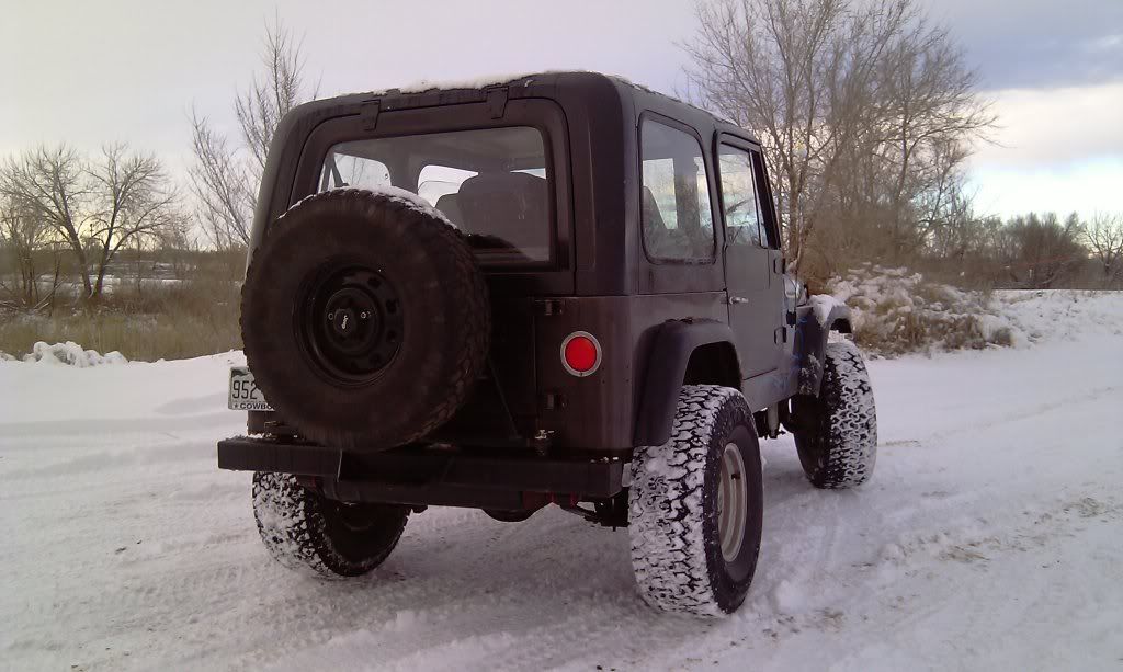

Well i finally got my tj flares done a few days ago so i thought i would post up a couple pics

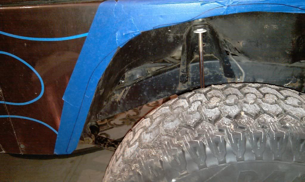

Cuttin the front fender

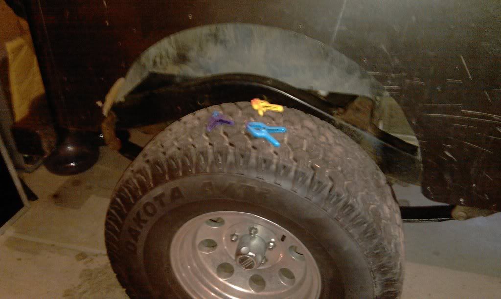

Back wells cut... See where I use to rub

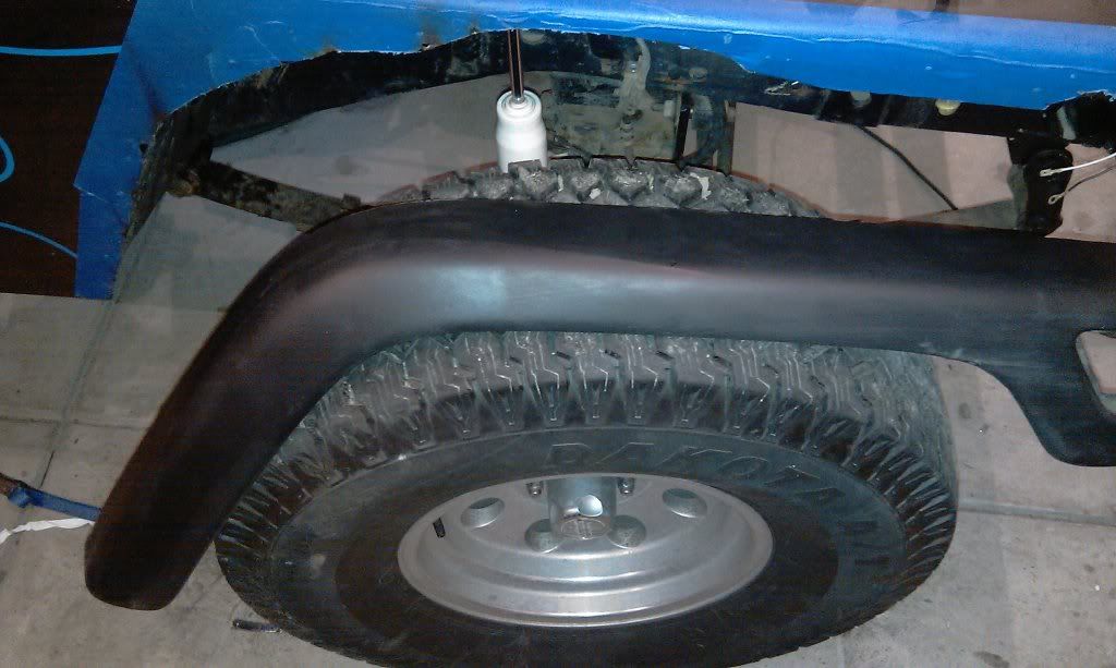

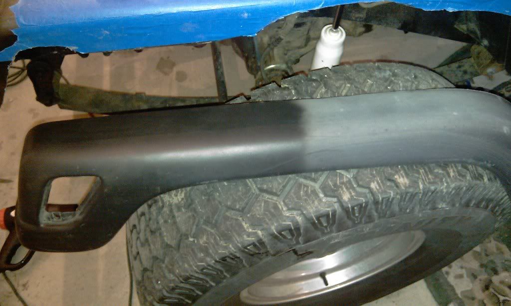

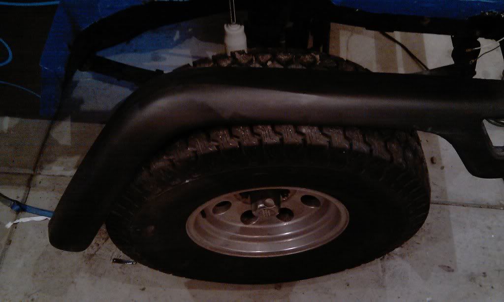

The tj flares were all sun faded so i took a heat gun to them
Before...
Halfway...
Done...

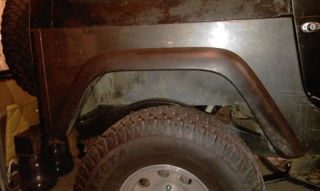

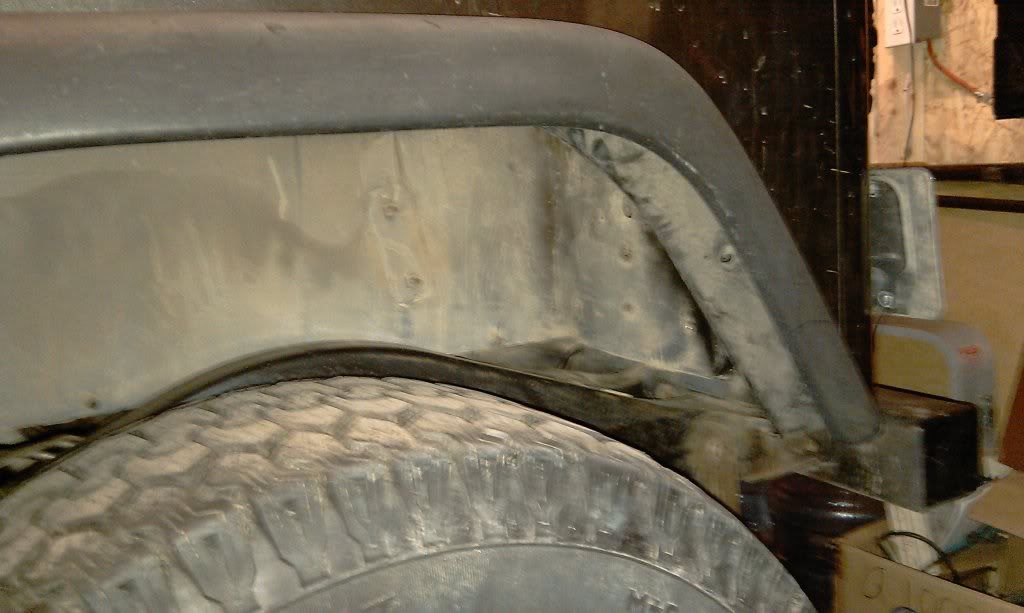

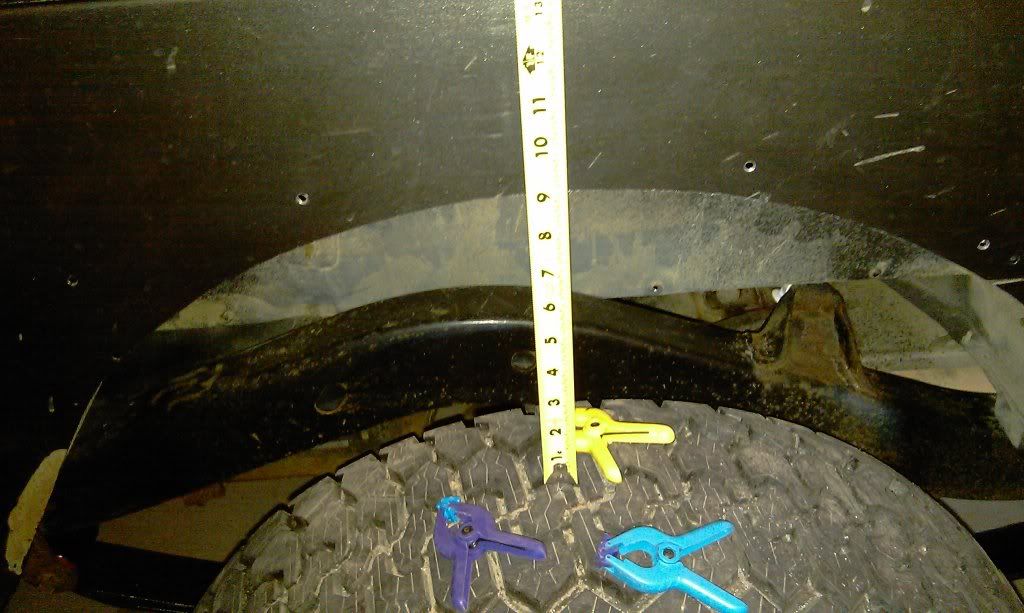

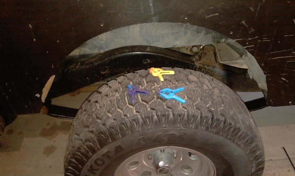

Rear installed... Not done with the heat gun yet... 33s look a little more comfortable in there

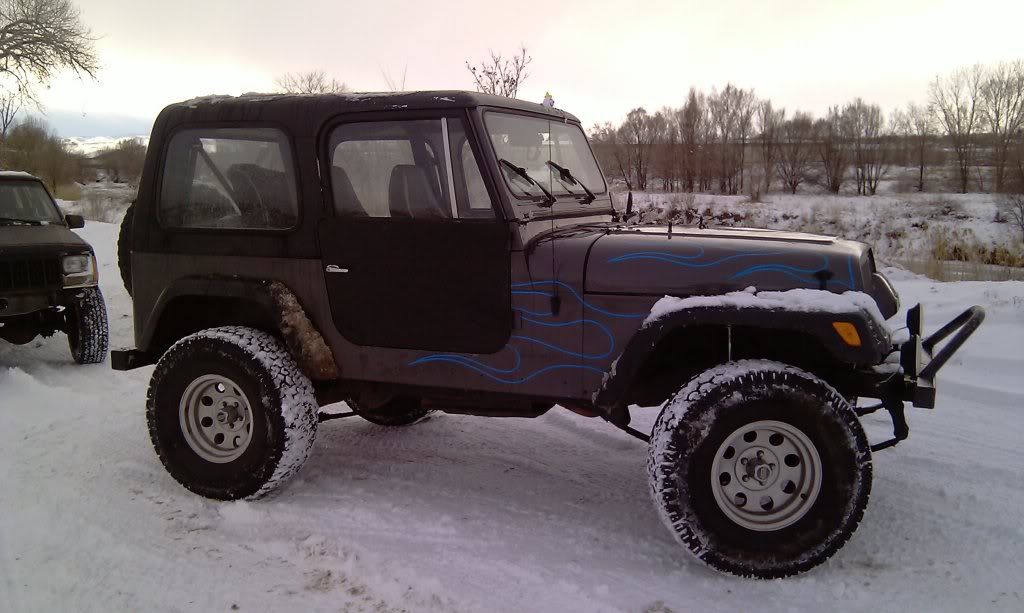

All finished pretty simple mod and love the way it looks...
Thanks for looking let me know what you think ... LONG LIVE THE YJ

I use to rub my rear well with my 33s at full flex no fender flares on . Now that the tj flares are on and i cut out the spots that had to be cut , at full flex dont come close to rubbing . Same with the front too. Plus i like the way they look . Def a cheaper alternative to doing the tubes .
