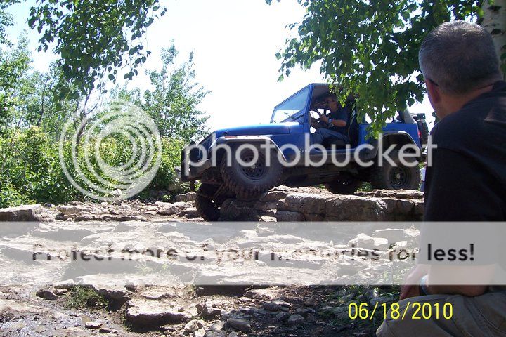

Bushwacker flares are terribly tight and probably designed for a Yj. You need TJ size for a 35" tire.
I don't know, I was running 33's with Bushwackers on my last YJ and thought they had plenty of room.
That picture looks familiar! Drumond Island, Marble head?
Precisely. :-)
