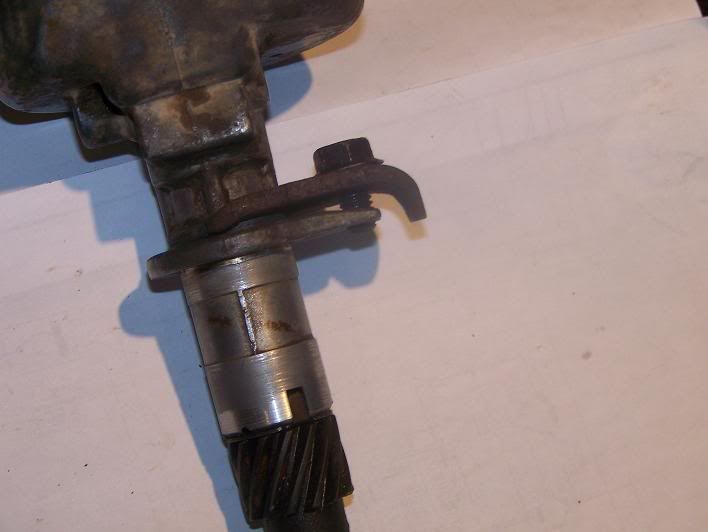

This is what you use to clamp down your distributor, but if one of the "locking ears" covers the bolt hole, you might have a problem - I don't know anywhere else you can bolt it.
This is how it fits on the distributor:
I could send you one with the ears broken off if you're interested in paying the shipping - distributor would be free (no sensor included, you could put your's into it).
