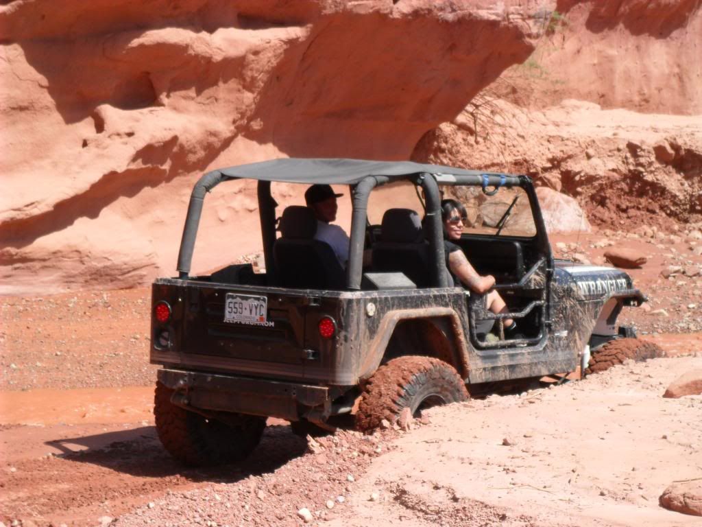

I measured before and after I installed my 3.5" springs in the front but I cant remember what the measurements were I think i got an additional 1-1.5" over my old springs, but the problem is I don't even know what those were. Plus I never measured after I broke them in. All of my pics with the 'Cloaks are with 3.5" BDS springs and 5/8 booms.
Would have flexed farther on this one, and 35s would have probably rubbed.

It only feels like too much for 33s with metalcloaks. Stock fenders would be fine, and 35s with cloaks will be awesome.
Sparrows, are you set on 1/2" booms? If it is too much you could go with zero lift booms to bring it down. Depends on the terrain you wheel, but I like uptravel
