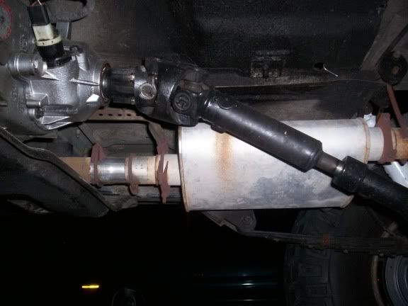

Originally Posted by mp3coupe
Does the XJ shaft look like this?
no, that's a flange mount style. the XJ shaft bolts up to an open end yoke like the YJ's front DS except the fixed yoke that bolts to the t-case is drilled through to pass the mounting bolts. the threaded part is part of the CV. you can see mine below.
