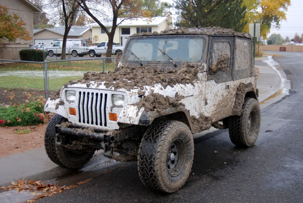

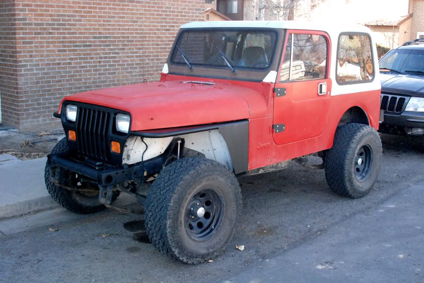

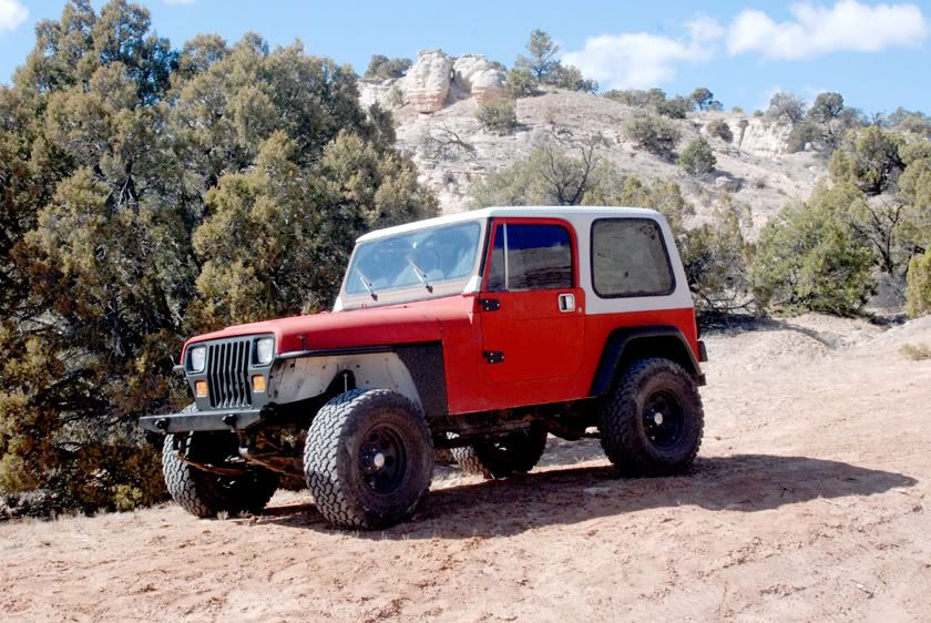

I guess it's finally time that I should start a build thread. I wish I had done this a long time ago.
Here's how it looks as of today:

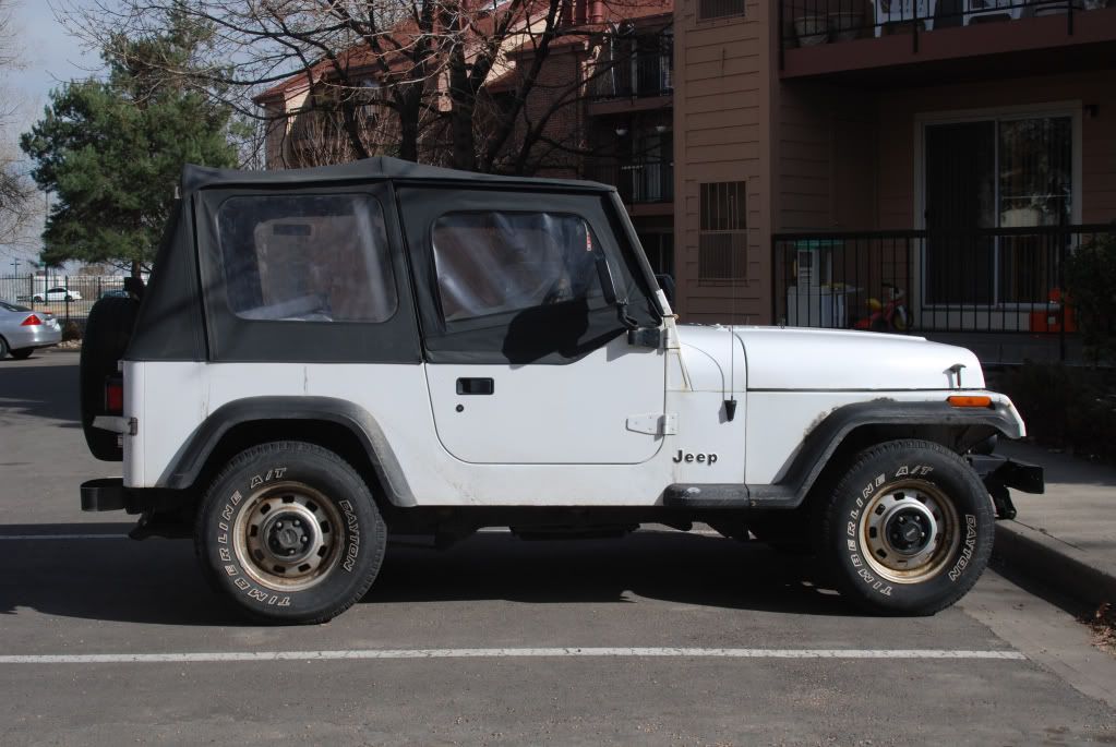

But here is how it looked the day I brought it home.
I saved up all of my pennies and threw a 4" RC lift kit and some used 32's on a set of wheels that were off of another YJ.
Then I got some 33X12.50 General Grabber AT2's and brand new cragar soft 8's. They're 15X8" rims with 4" of backspacing.
Next I got tired of the soft top... So I found a hardtop and full fiberglass doors off of a CJ7.
1995 YJ 2.5 - 4 RC lift - 1" MML - 33's - flat fenders front - TJ flares rear -Raptor lined exterior - Herc'd interior - DIY front bumper & winch plate - 136 amp alternator mod - 4.0 TB swap

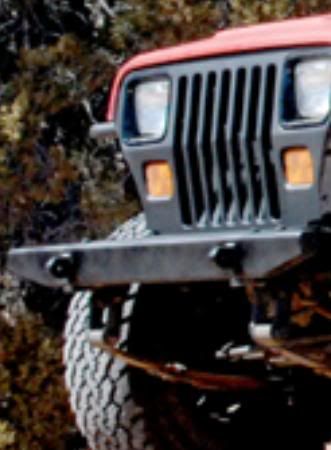

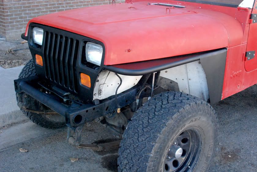

The next thing to go was the stock front bumper.
$50 in steel and a few days in the garage resulted in this:
Then a couple of anchor points through welded in the center of the frame, a little bit of bondo and a couple cans of paint later...

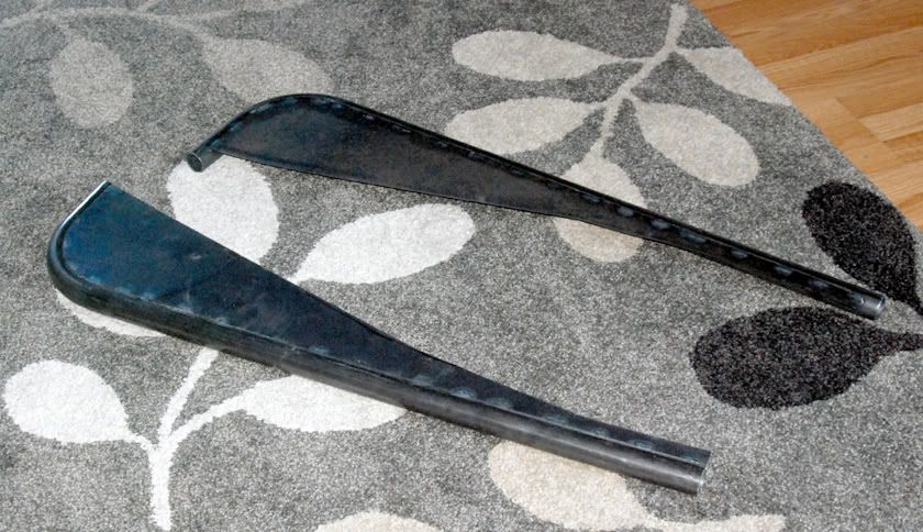

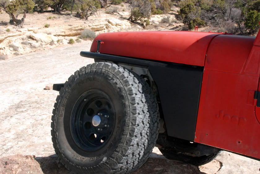

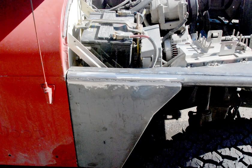

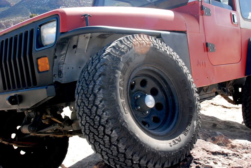

Next up I finally found the time and money to do my flat fenders.
Here's the before pic. (me on my way to go deer hunting) You'll also notice that I did a cheap Krylon spray paint job. I plan on doing a nicer black paint job in the near future.
I started by cutting along the lip of the fender that runs under the hood. I cut until I got to the inner fender.
I left the bracket for the hood latch support though. I just ran the jig saw along the lip so there is about a 1 1/2" lip running under where the hood shuts.
Next I cut along the back side of the inner fender behind the tires and I made a vertical cut about an inch or so from where the fenders meet the tub.
Then I took an angle grinder to the metal remaining on the inner fender and cleaned it up a bit. The front side (towards the tire) is nice and flush now, but I left the back side rough. You'll never see it and I was running low on wheels for the angle grinder. I did cut that rust out though. I also just unbolted the part of the fenders that was still attached to the tub.
I had to notch the inner fenders a bit to make room for the 1 1/2" tube to clear. It's not pretty, but you won't see it.
Then I trimmed the fronts of the old fenders off along the grill and took an angle grinder to the metal bracket behind the top 2 bolts on the grill and smoothed it down flush.

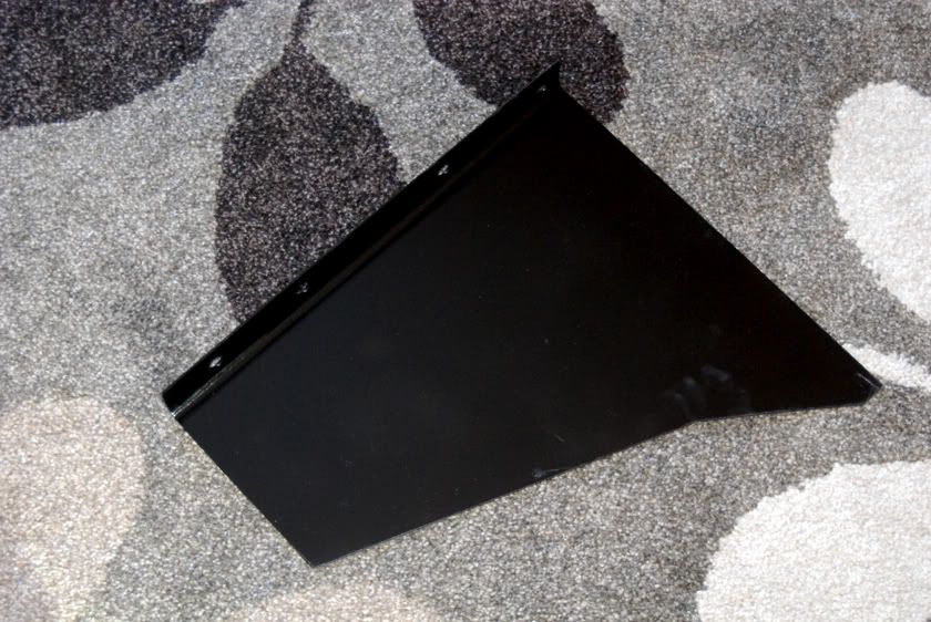

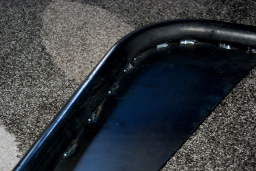

Next I welded the top part to the tubes and painted the bottoms before installing them because I knew I'd never be able to get to them with paint after they were on the Jeep.
I also painted the backs of the side plates before installing them.
Then I trimmed the tubes to length and welded them to the inner fender by the grill and ran a bead between the tubes and the side plates. I was using a $100 harbor freight welder so you'll have to pardon the booger welds. They cleaned up well, but they're not pretty in these pics.
And the full length shot:
I hit the welds with the grinder to try to smooth them out a bit. I also filled the gap on the top section and the sides between the welds and the tube with bondo and sanded it flush.

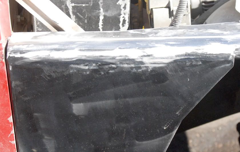

I got the grill and fenders sprayed with a spray on bedliner. Now it's finally about ready for paint. I just need to save more of my pennies up

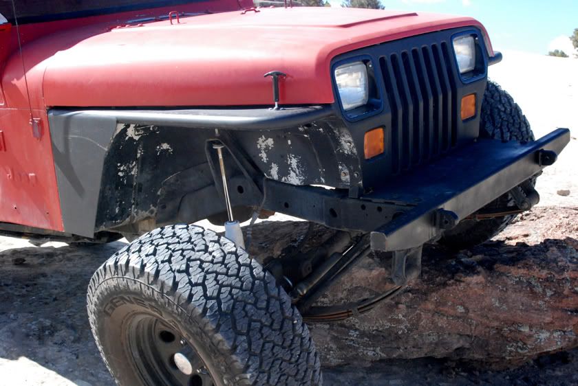

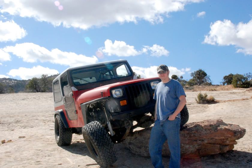

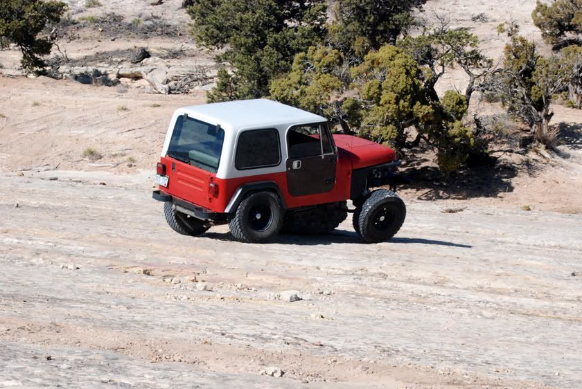

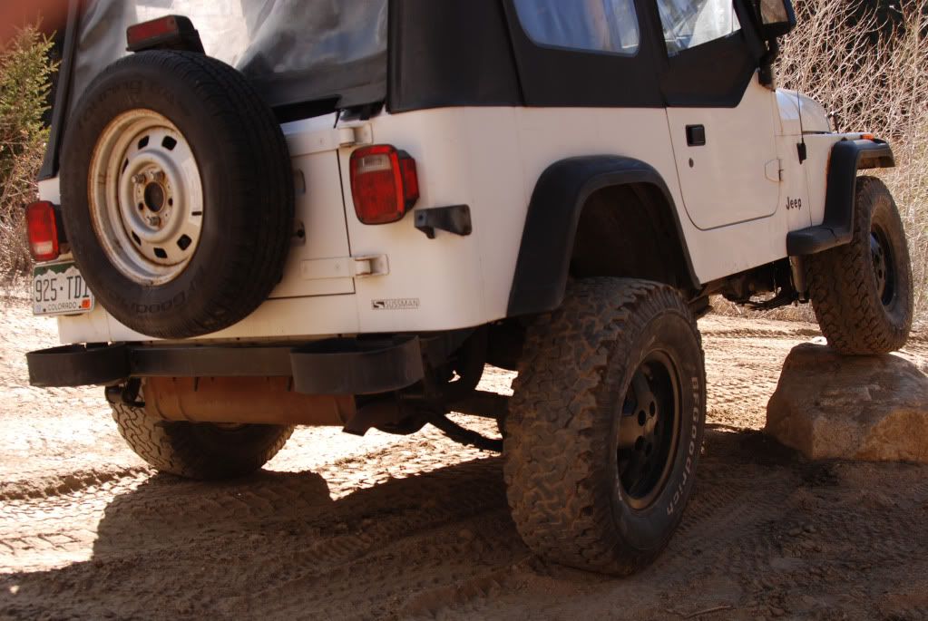

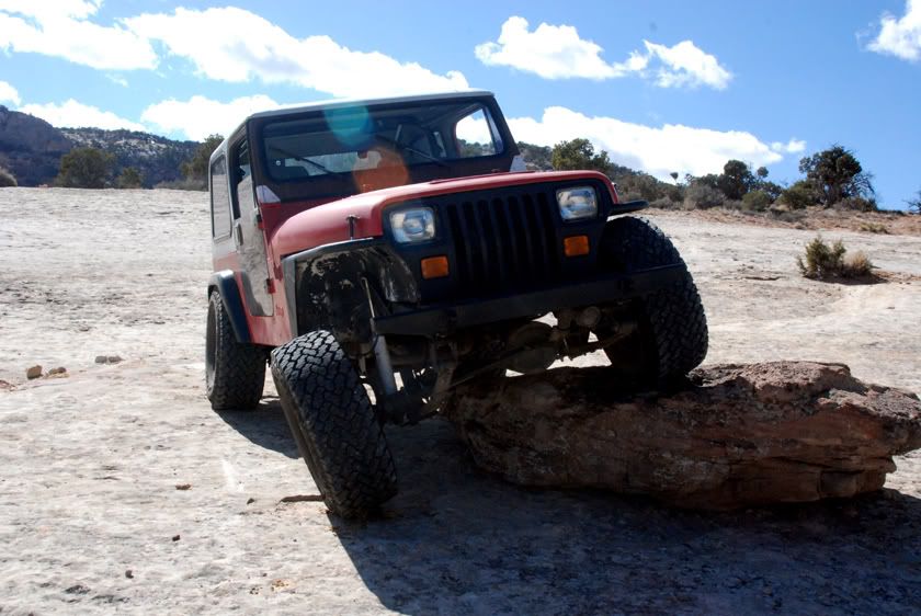

Here are a few flex shots with the new flat fenders.
I also cut some metal in the back an installed some TJ flares. Look that those 33's stuff in there!!! I'm not running bump stop extensions in the rear, so the 33's fit PERFECTLY with the TJ flares. I needed the bump stop extensions to keep them from hitting with the stock flares though.
Adding the TJ flares and removing the bump stop extensions was GREAT for flex. I never thought I'd be able to get this kind of flex out of RC springs.
I also found some full steel doors on craigslist. Those old fiberglass ones just weren't cutting it.

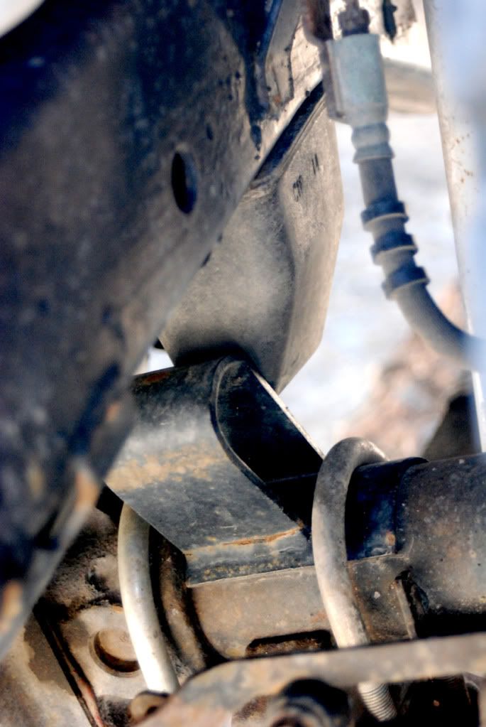

My bump stop extensions are a little bit off center up front, so I can almost stuff the 33's into the tubes.
Here's what the front bump stops look like under flex...
