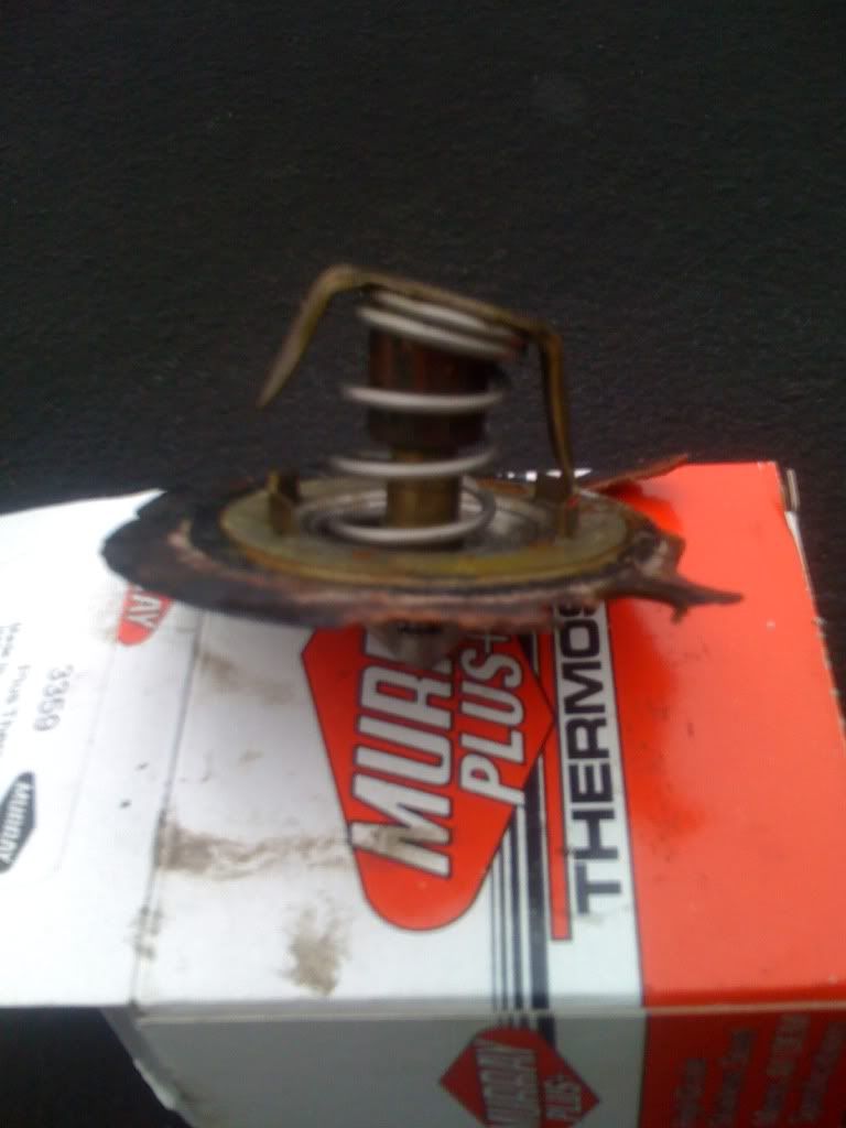

What the heck? How did it get bent like that?

That's how it looked when i pulled it out today. I asked my dad if he has ever seen a thermostat busted like that and he said that this was definetly his first. I have no clue how it did it.

The brass failed either through corrosive action of the coolant or a mechanical failure. It's bent because the spring pushed it away from the 'base plate' (whatever it's called).
I have seen that, maybe 3 times in 13 years of servicing cars.
As for your gauge, I recommend you remove the little connector at the back of the head that was circled by mightybg. The gauge should fall to dead cold. Then ground the connector. Gauge should read full hot. THIS IS TO BE DONE WITH THE ENGINE OFF, KEY IN "RUN" POSITION. If it works fine (low/high) then replace the sensor.
