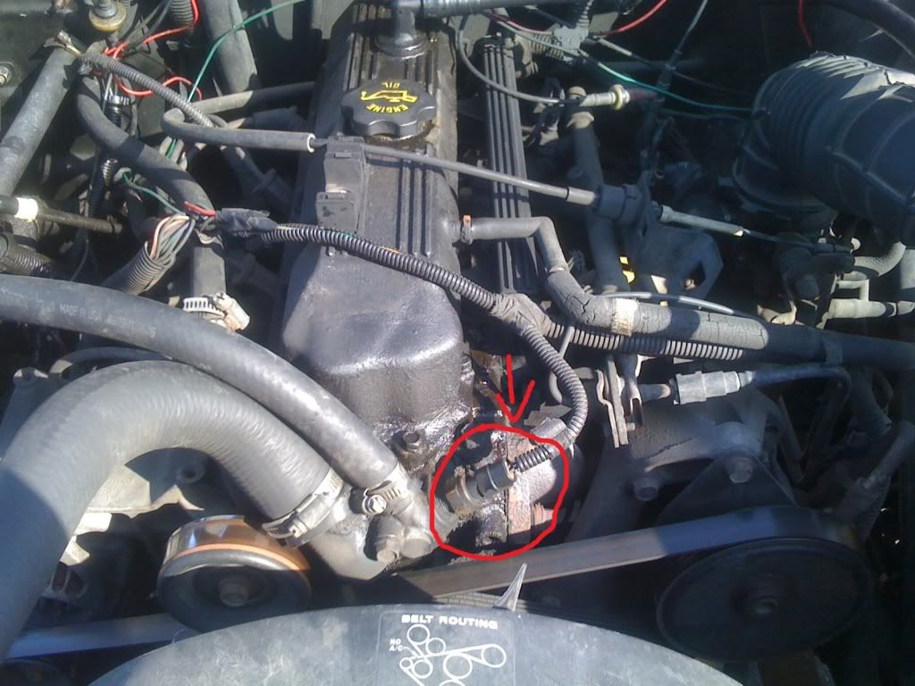

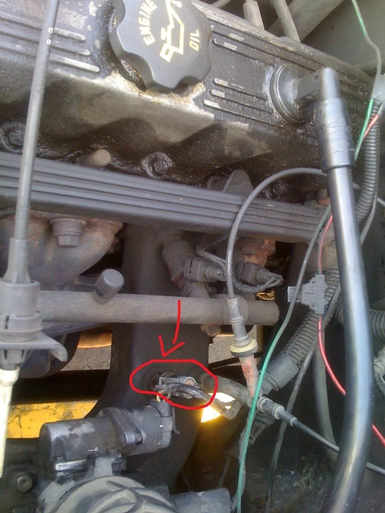

My '93 2.5L was running and driving fine then I shut it off and went to drive it the next morning and my temp guage stayed on 100 the whole drive to work and when I went to turn my heat on there was no heat. I took my guages off today and looked and it was all surprisingly clean.
This is the sensor for the computer correct?
Is this the sensor for the temp guage?
Most things I have read said that it has only 1 wire and this one has 2?
Anything would be helpful, I would like my heat back

My question, I guess, is what do I need to replace?

If my thermostat was stuck open wouldn't that make the antifreeze constantly run through my heater core? Neither one of my heater hoses are warm going into the heater core.

Im gonna go out on a limb here and say your thermostat is stuck open.
Also looks like its time to replace that vaccume hose in the top pic.
Stupid question but which one is the vacuum hose?
And what would the problem be that is causing my temp guage to not do anything? Or should the thermostat change fix that?

And as far as the vacuum hose, I think he's referring to the decayed looking one running from the valve cover to the intake. But the decayed part is just a rubber coating. The hard line inside is probably fine. But it's never a bad idea to take them off and inspect them.
