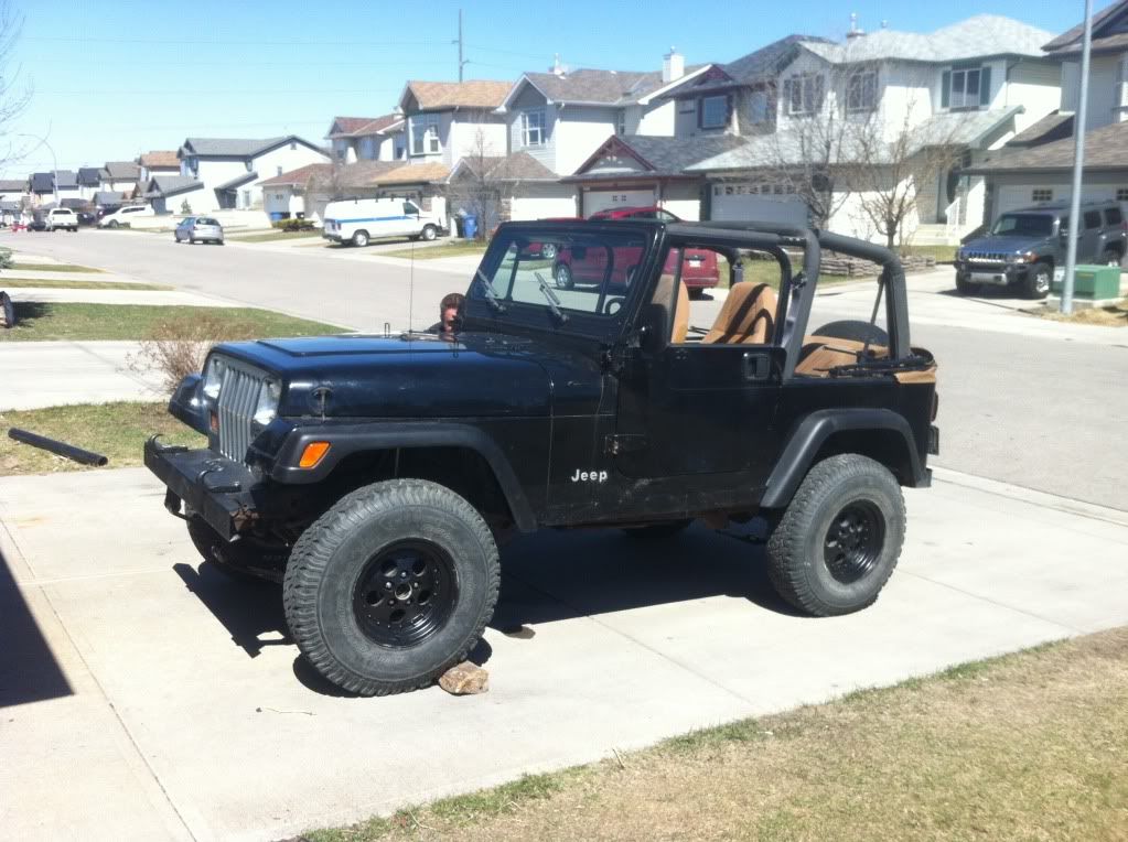

so kits installed. first off, its way higher than 2.5". i think RC uses the same springs for a 2.5 and a 4". one sags, one rides high. oye. does ride decent though; it has some driveline vibes, which i assume is due to the height; i'm going to put a tcase drop on it to help it out; although i'm sure if it sags a bit that wo uld help it.
i took the track bars and sway bars off and didn't really tighten the shackles. it rides better than stock. for price, very happy with it for now. and like i said, i hope it sags! its to tall. here's some pics
07' JKUR rollin on 35s
