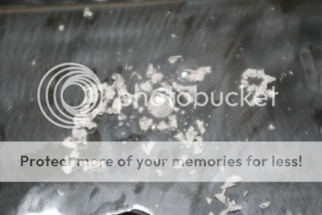

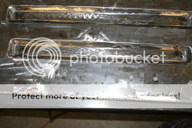

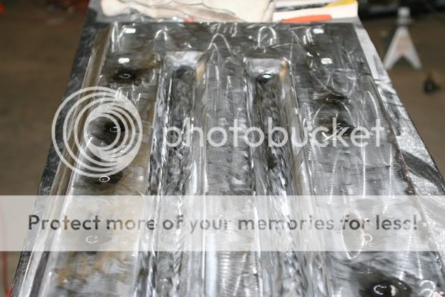

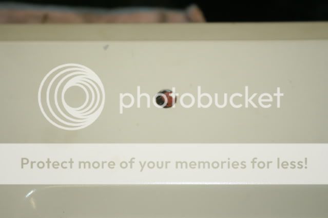

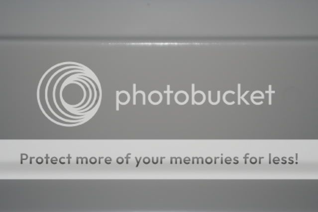

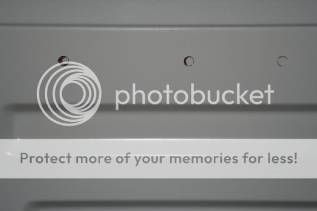

Here are the pics of the failed glazing compound.
My YJ Build Thread
firefighter315 is offline
post #48 of 61 Old 03-30-2009, 11:15 PM Thread Starter
firefighter315
Location: Kentucky
Posts: 1,827
Originally Posted by 93jeepyj View Post
you may have better luck with bondo there. they glazing/spot putty is really only for tiny imperfections in paint or bondo and thats probably why it cracked. Thats too bad it looked good but im sure itll come out even better now that youve had a practice run.
I thought about going that route, but think I'm going to try to bring them all the way out with the JB since I still have plenty of that left. It cured REALLY hard and sanded well. I thought I had them shallow enough for the glazing compound, but as you can see, I was WRONG! I would guess they were around 1/32" deep before putting on the glazing. This was my first experience with the compound and a good learning opportunity. It did hold up well across the bottom where I got the cancer out. Those areas were much more shallow and I guess within the limits of this product. I'll repost the fix once I get around to it....

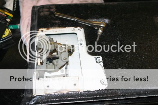

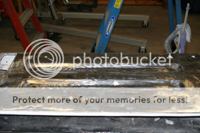

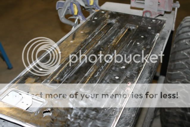

Also over the weekend, FFJeep came out to help finish up some wiring of accessories while I turned my attention to a much overdue fix on my tail gate project I did a couple of years ago. You can find that project in the FAQ/Project section or here:
http://www.jeepforum.com/forum/f12/t...roject-665733/
I'll make updates to that thread when I am totally done with it. The first time around, I used some JB Weld to fill the bolt holes from the carrier I removed, then finished them off with some glazing compound. That combination didn't hold up well to the temperature changes and the glazing compound cracked and looked like crap. This time around, I took the advice JeeperDon gave back then and drilled out the JB Weld and filled the holes with my welder, grinded them down flush, and will finish them off with some bondo to fill any imperfections. Hopefully this will be the final fix. If not, I'll have to come up with something else.
Here are a few pics from this project.
Original attempt gone bad...

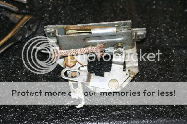

Removing lock/handle hardware.
Ready to work.
Wire wheeled and flap disc'd
In this one, you'll also see some rot at the bottom that I'll have to address.
JB Weld drilled out.

I filled all the holes with my welder and began grinding them down.
Next I'll get to work on fixing the cancer hole and the old plug hole where the 3rd brake light wiring came through. Then on to smoothing, priming, and painting. Thanks again for reading about my progress and projects! Feel free to offer any advice or suggestions on this rear gate project. I am most definitely not a body work man!
