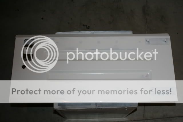

I know a million people have probably already done this, but I was a bit bored when I did it and ended up taking some pics, so I thought I might as well post a thread on it. I recently got tired of having the OEM tire mount and third brake light on my rear gate and took them both off. The PO only had a small dry rotted spare on it anyway and it served me no purpose when running 35s. I knew when I took it off that I had a little cancer along the bottom edge of the gate that needed attention. I also wanted to come up with a way to fill, cover, deal with the now empty bolt holes in the gate.
I originally threaded in some new hardware that I had painted to match, but ended up not liking the "Frankenstein" bolt look it gave. Being bored and looking for winter garage projects, I decided to remedy the problem and make the mounting holes go away. I never plan to reinstall a tire carrier to my gate anyway as I feel it is a bad design when it comes to larger tires. I started by grinding off the rust area along the bottom and another smaller area near the center. Quickly got to good metal and smoothed it out with a Dremel and some fine grit sanding discs. Rather than have a patch work paint job on the gate, I decided to fill, prep, and paint the whole thing. I'd rather have a slightly mismatched tailgate for a while than a gate with strips of varying color. I started by filling the bolt holes layer by layer with some 4 minute JB Kwik.
This stuff is great because it is workable so much faster than the original JB Weld. Downside is you have to work fast with it. I allowed the holes to self level and continued to layer the JB until each hole was hardened with a very slight concave surface to it.

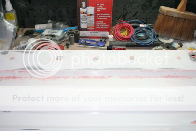

I did this to all of the holes, including the one previously occupied by the wiring grommet for the third brake light and the ones where the rubber tire bumpers were.
After allowing the JB to cure, I roughed up the surface of each a bit and filled the now slight concave shape with Bondo glazing compound.
This brand glazing compound sets up in around 15 to 20 minutes and can be easily worked after around 30. I also used this to smooth and fill the area along the bottom edge where I removed the cancer.

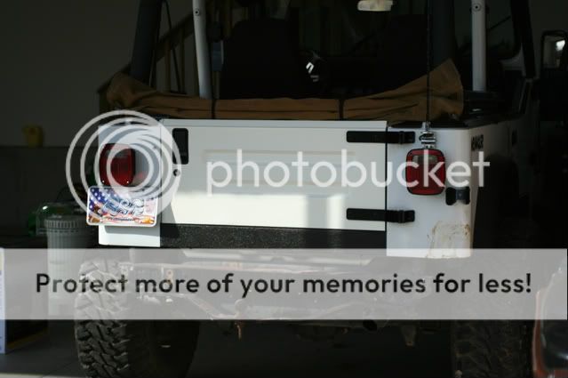

I finished the paint job with some Krylon Fusion rattle can paint. This is the paint that is marketed for use on plastics, but it also works well with wood and metal applications (or so the can says). I guess I'll find out over the next couple of months if that is true. I put on three coats of paint and two or three coats of clear coat. No wetsanding in between and it still came out VERY smooth. I am pleased with the results of this rattle can paint job. It's amazing how well it works when you actually follow the directions on the can. I have a history of not doing that....
Here it is with the latching hardware reinstalled. I also cleaned that hardware up and hit it with some Rustoleum satin black.
After allowing it to cure for a day or two, I reinstalled it with the hinges that I had stripped and painted black along with all the other hinges on the doors and windshield....after a couple of adjustments, it was opening and closing smoothly....
Ignore the pitiful excuse for a hitch in those pics....PO installed and I don't use it. Hopefully I'll get it cut off soon and get some respectable bumpers on both the rear and front.....
