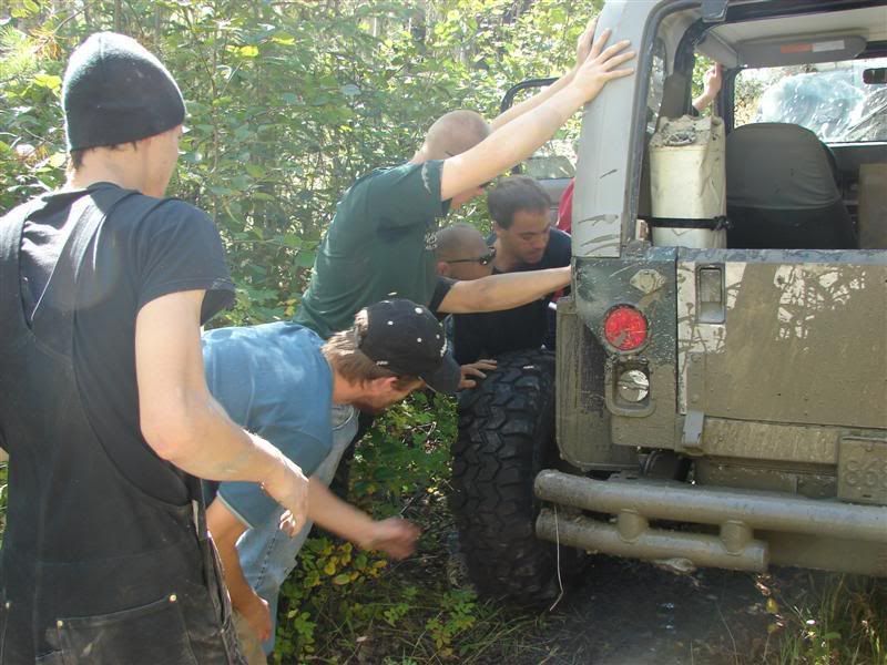

I used my YJ hinges, and just bolted them to the bottom, below the tailgate so they open down....
bottom left is the hinge, one each side, I use a flat piece of amuminum, to hide the dents and things on the back of the gate, and another on the bottom where the hinge bolts to, for reinforcement, and to level it...if you add a piece to the tailgate you have to add a piece to the bottom...or the hinge will lean in and wont tighten straight....and put a chain on the inside to hold it, works not bad for me. The Yj hinges are way more duralble then the CJ as well, the longer hinge gives the gate a solid feeling
bad place to blow a bead, on a side hill....LOL....everyone is holding it up while we change the tire....that was an experience
Originally Posted by giggityjeeper View Post
see mine I never had to worry about a latch, its all YJ...
That is a killer idea!
I probably would have just done the full CJ conversion, but this way sounds like it might work a bit easier. I know you said you reinforced the body where the hinges now mount, did you drop the gas tank to mount a plate behind that or no?
Also, do you sit on the tailgate at all?
