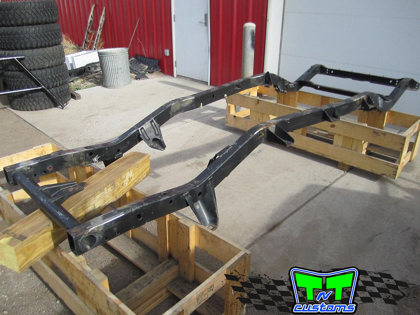

Took advantage of the great weather Saturday to start cleaning up the frame. Removed all the leaf spring perches and trackbar mounts. Front shock towers will die as well as the new front coil mounts resemble a TJ's and have a shock tower built into them.
- GO EQUIPPED !

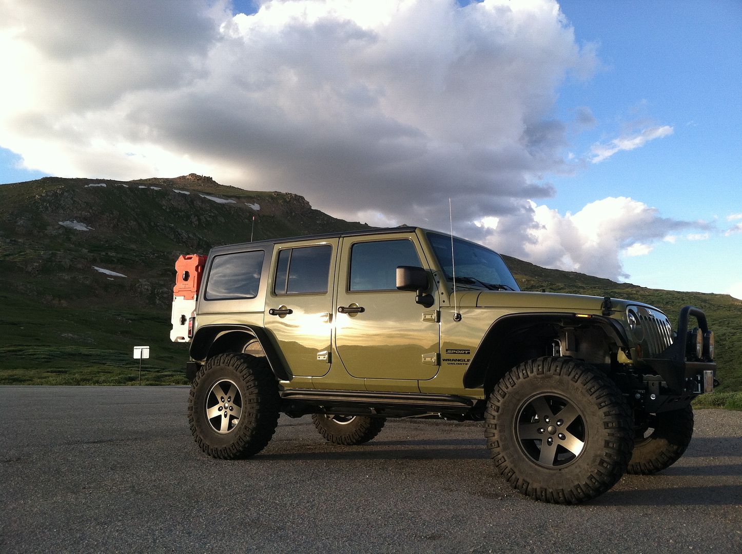

I needed something that was going to be drivable sooner so I purchased a 2013 JKU and built it up for the moment. We actually have a customer who may be interested in having us complete this project for him.
