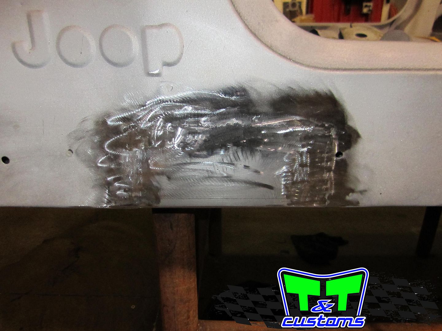

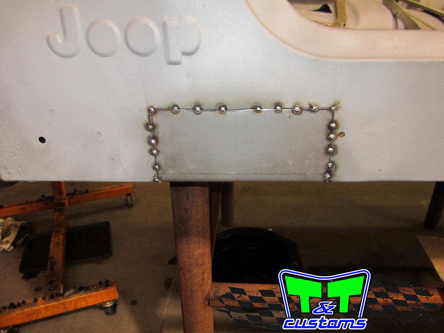

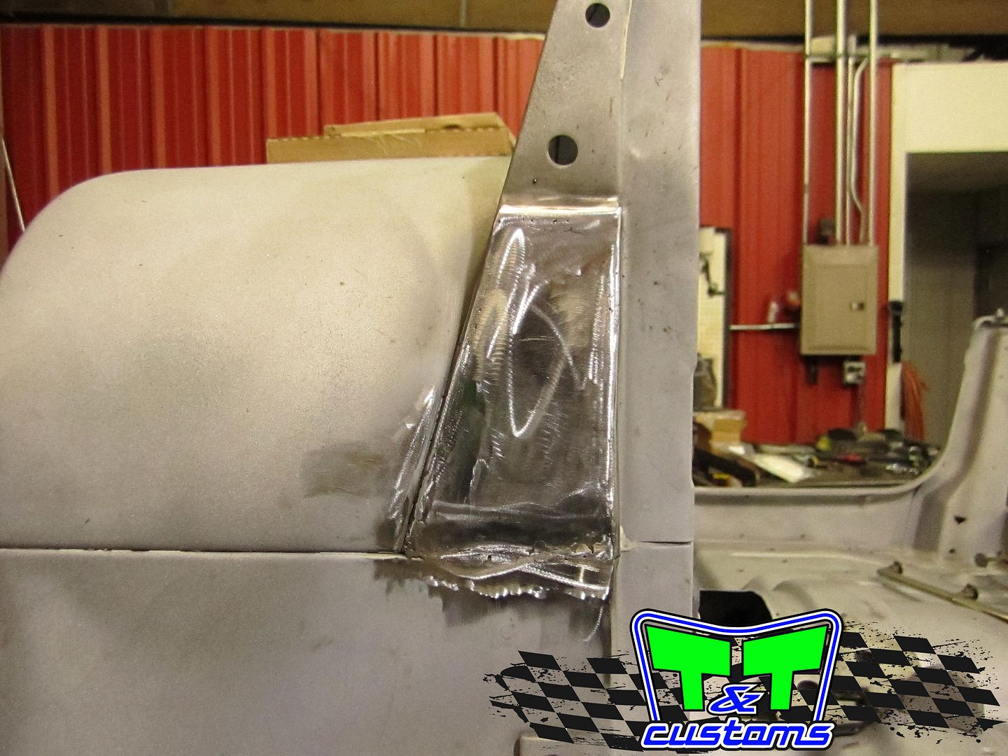

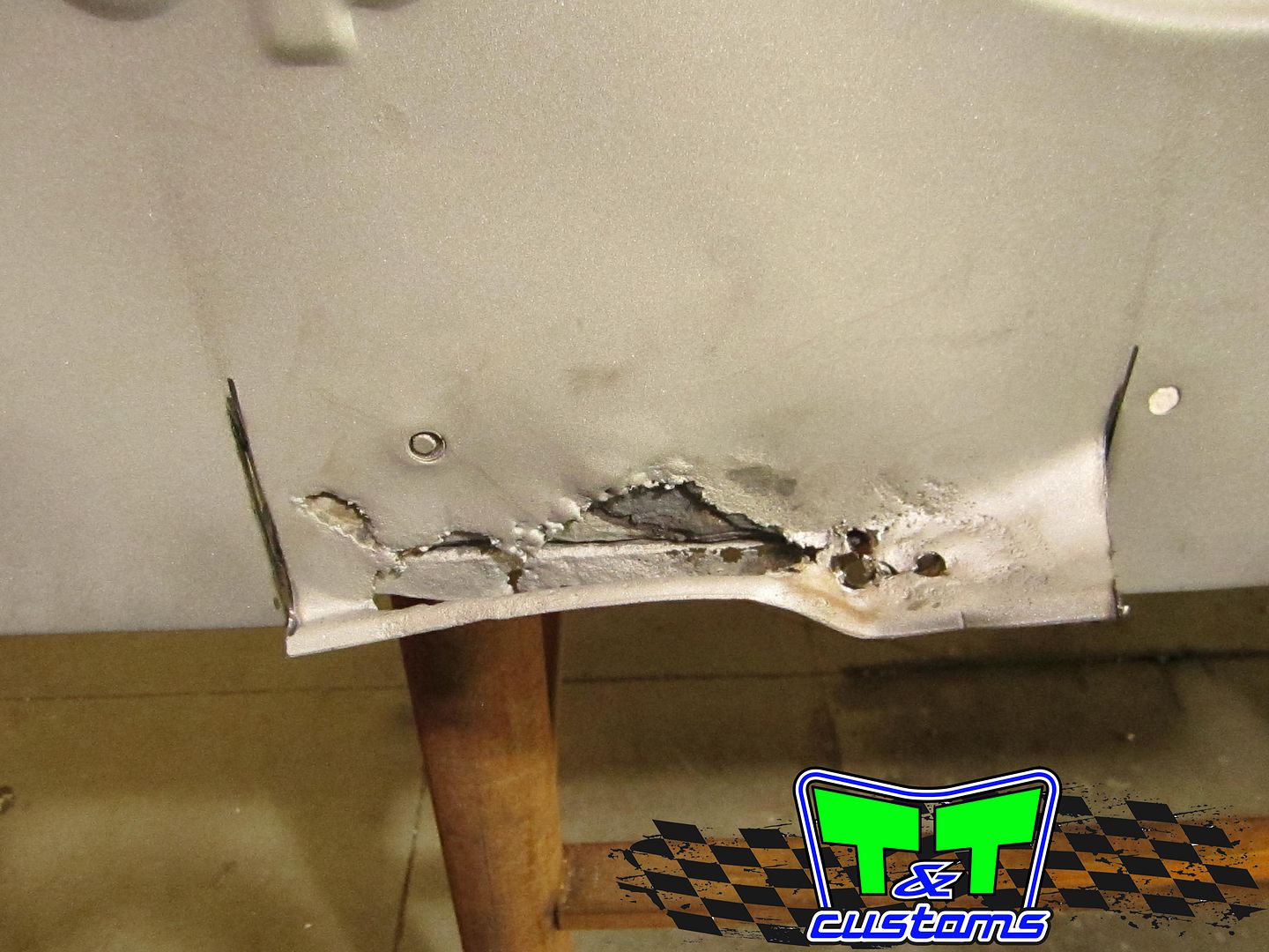

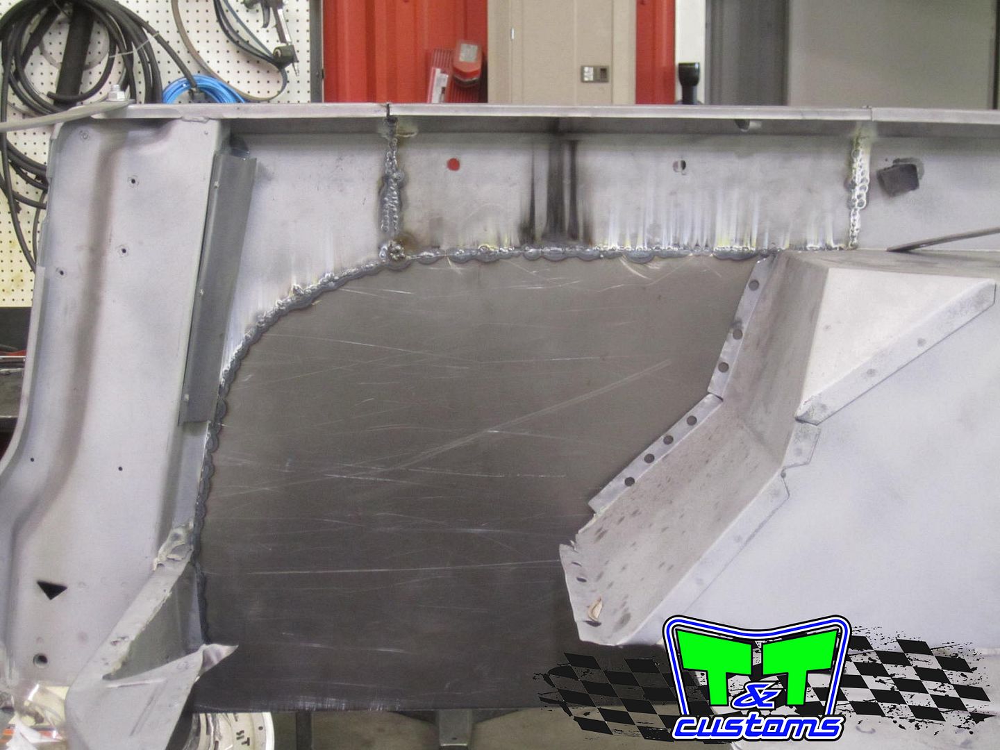

Started cutting out the "cancerous" portions of the tub
Like new!
Was a little concerned about what to do here.
Turned out not too bad. I know it doesn't match the factory piece as far as being recessed in the middle, plus we had to weld in the seam but it's going to be covered up with side panels similar to our TJ ones so luckily it won't be seen.

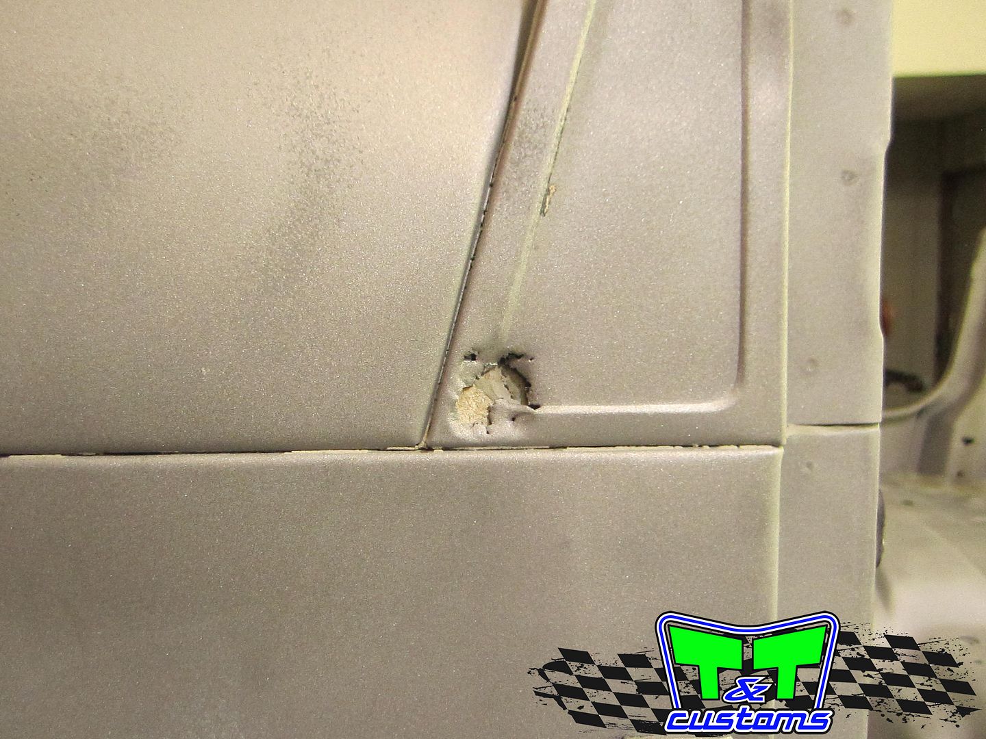

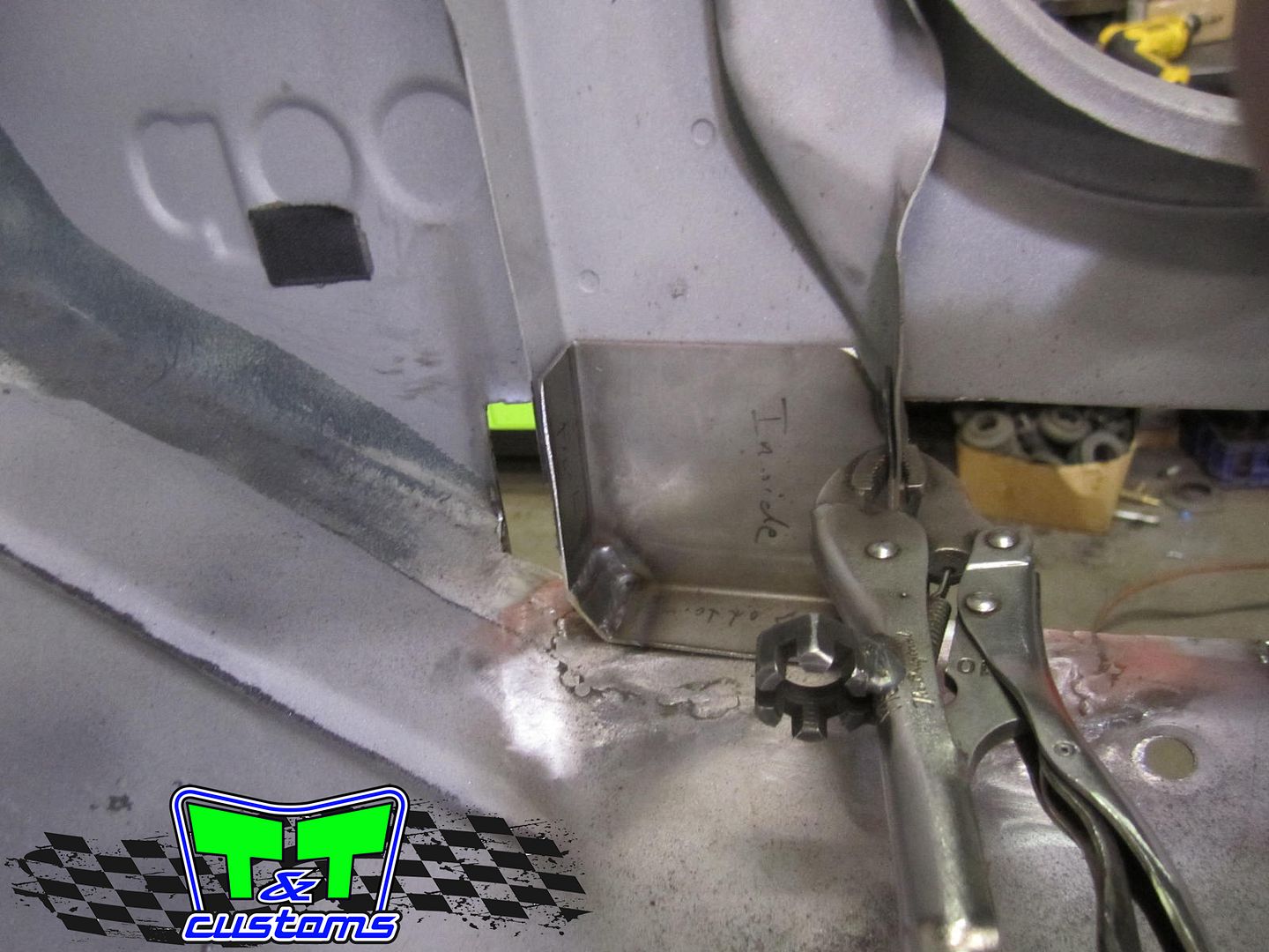

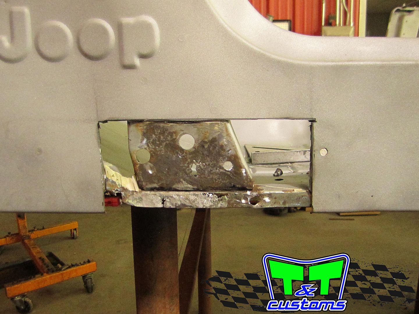

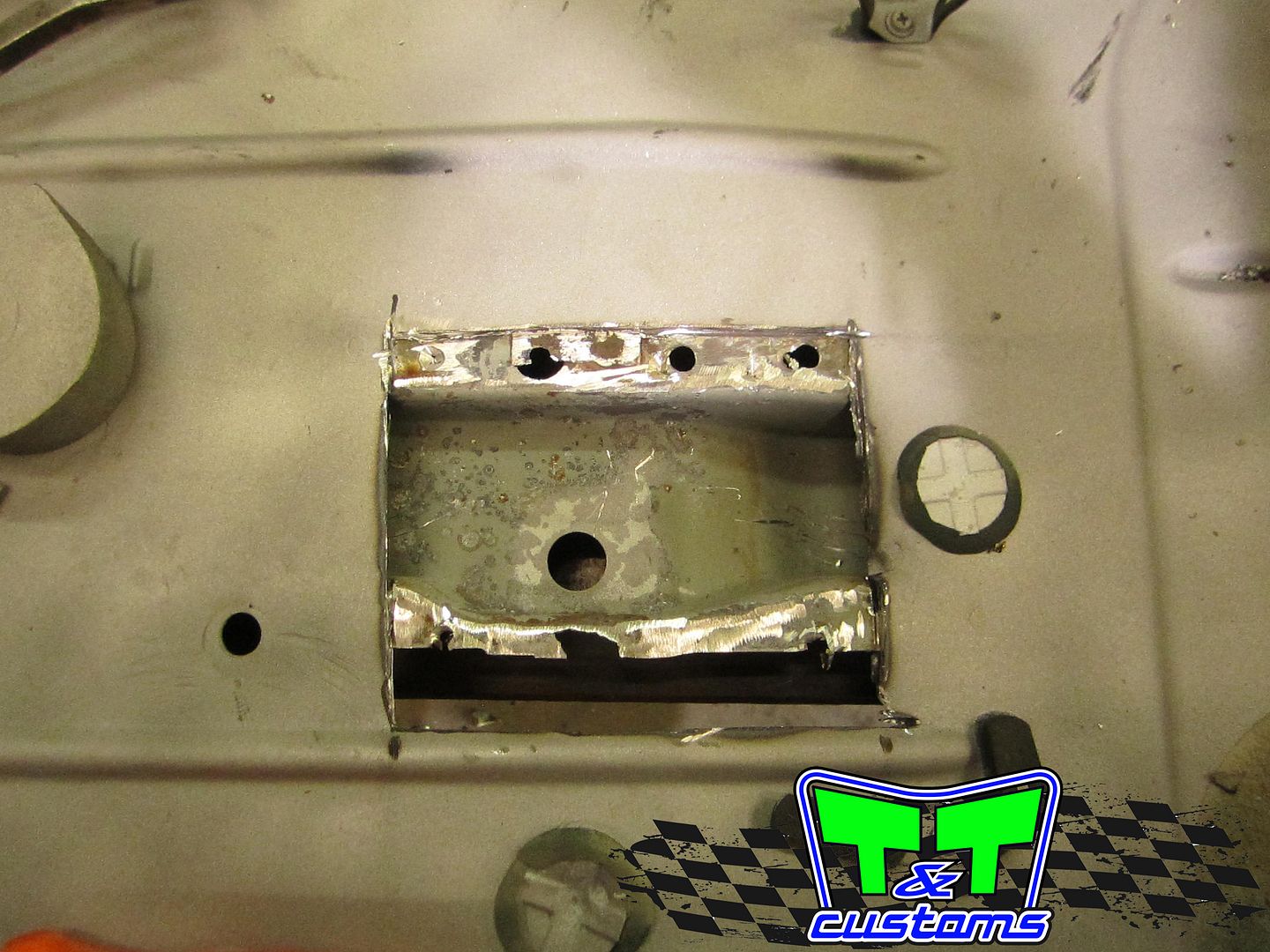

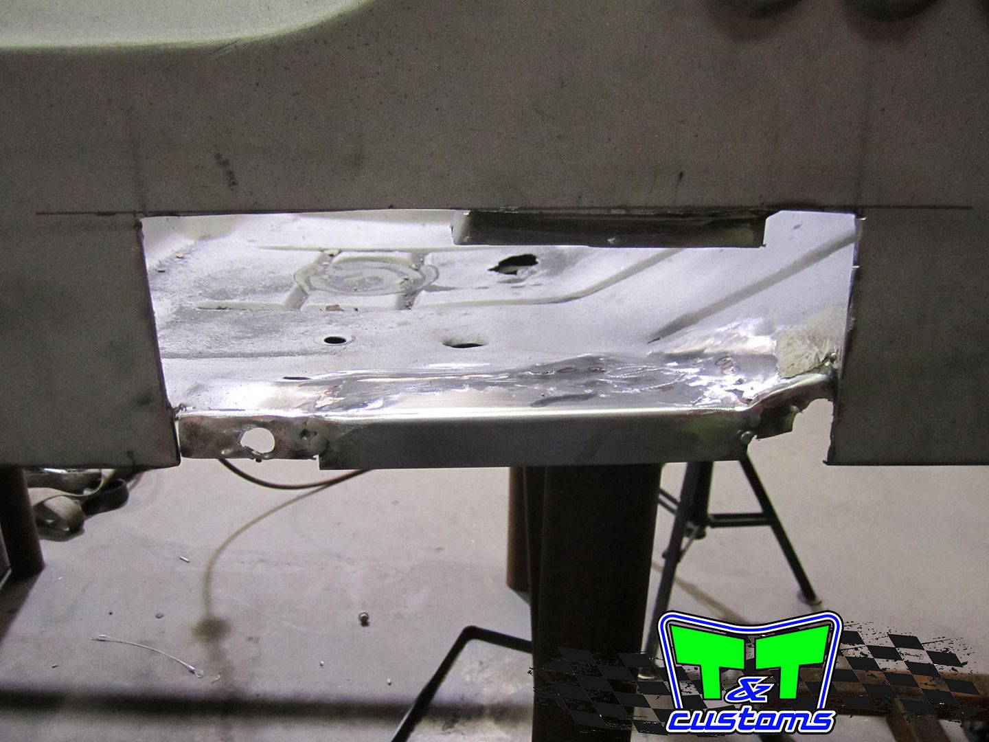

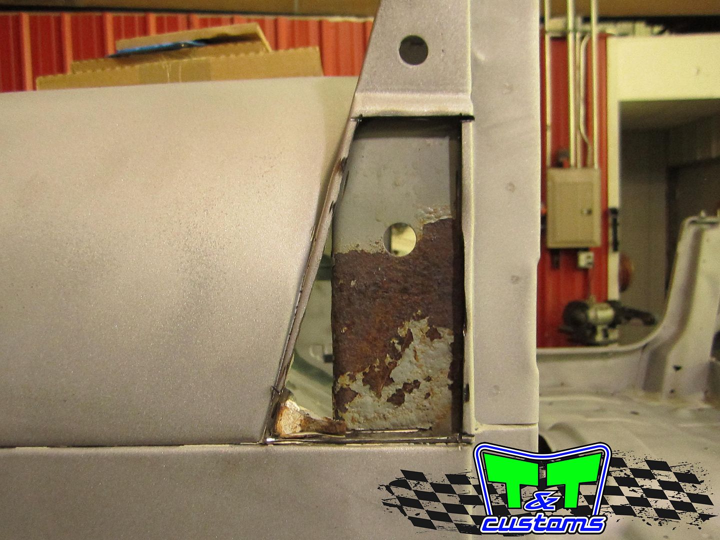

Cleaned up some spots in the floor
The passenger side rocker was pretty hammered as was the factory intenral brace so it all had to go...
made a new piece to tie into the brace...
Stay tuned as I start reconnecting the tub halves back together.

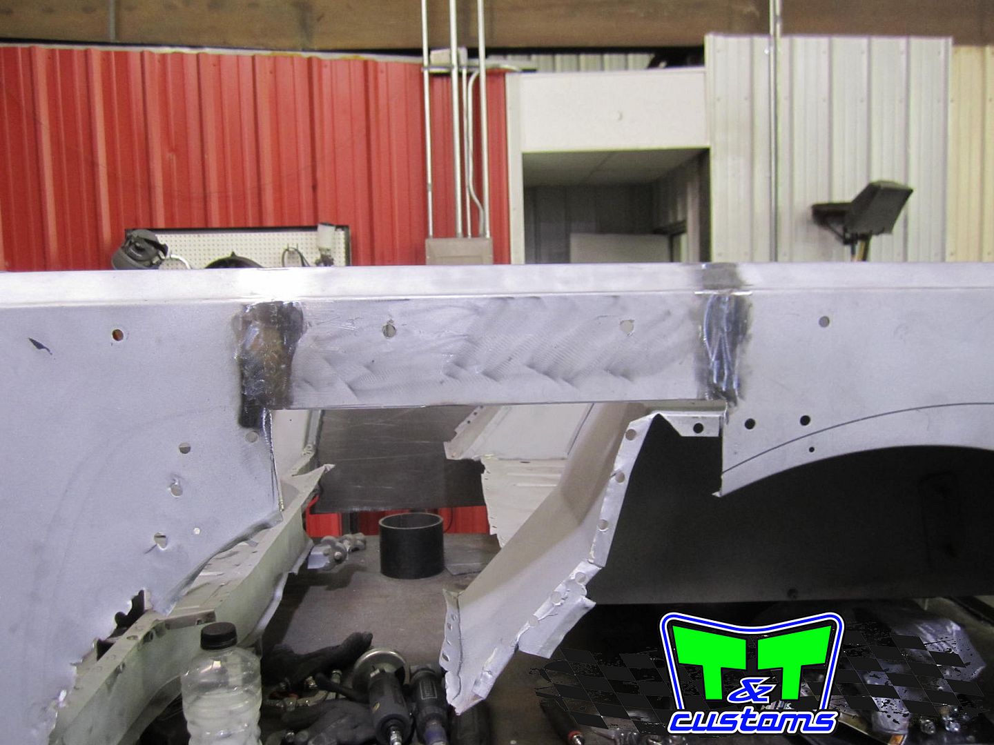

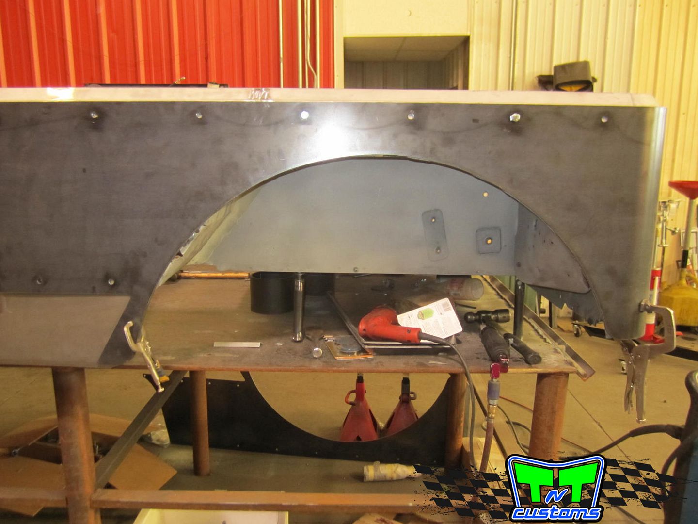

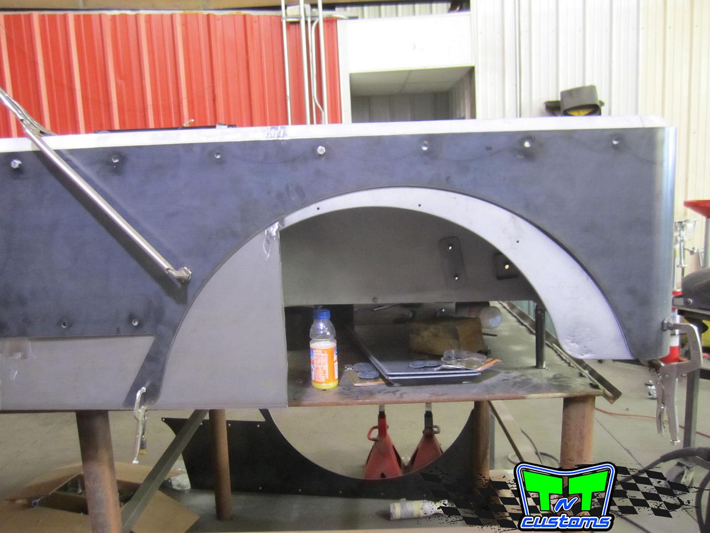

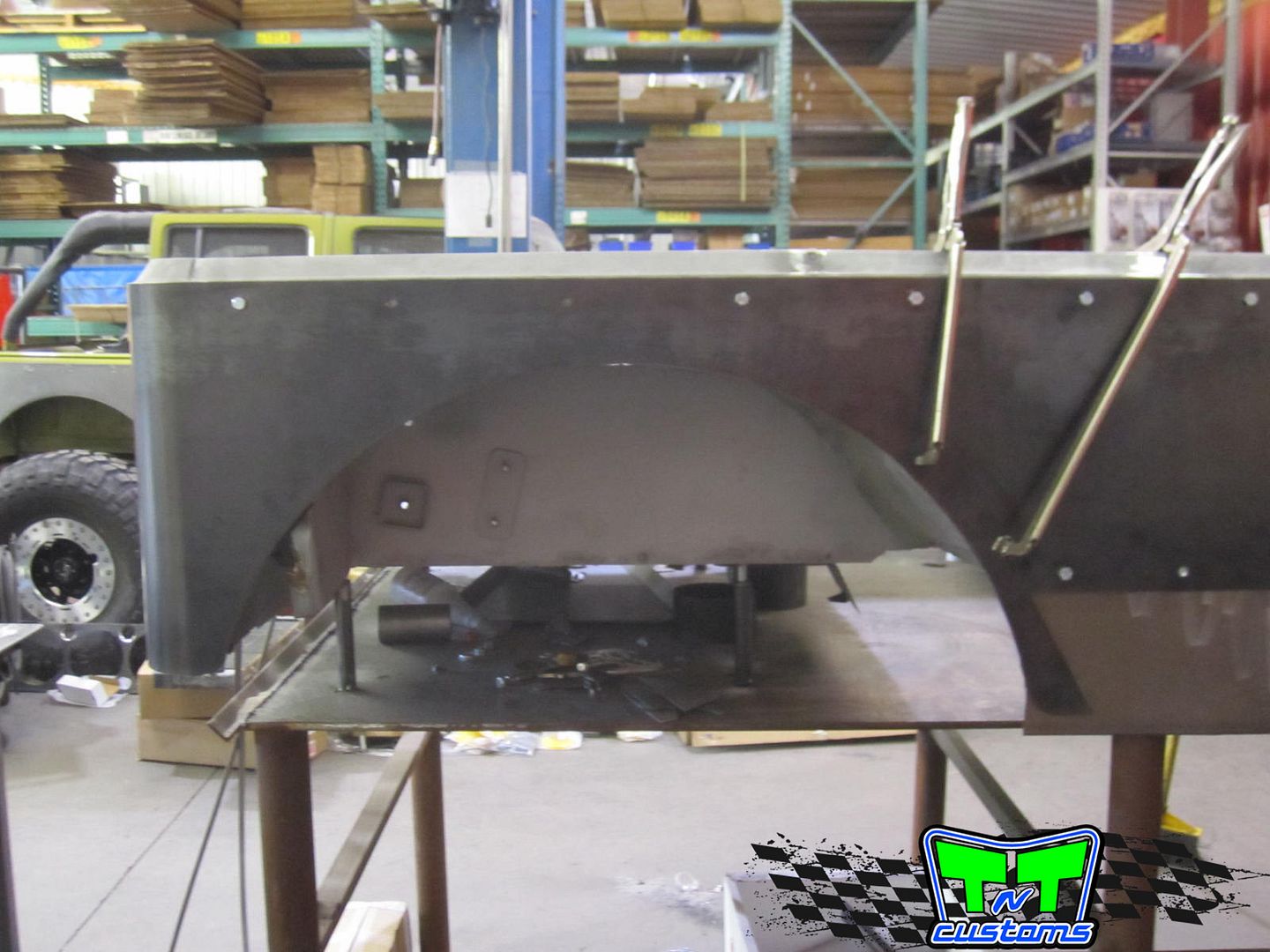

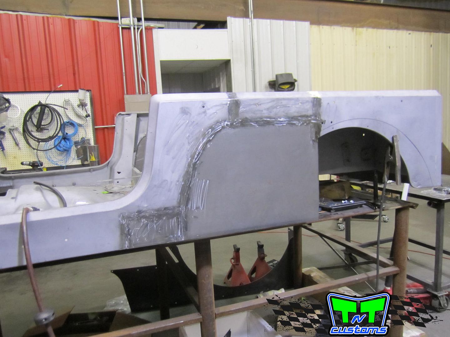

It's finally time to start grafting the two tub halves back together
Thankfully we had a junk YJ sitting outside that we were able to cut the needed panels from. Once we quadrupled checked all our measurements we cut them down to the correct length and welded the PS one in place. For those who are curious we added 15 3/8" in front of the wheel well.
Someone told me that it's better to run large panels with rounded edges when possible to avoid corners which can crack. Made sense to me so thats what I did although they neglected to mention is how much of a PITA it is to trim the round panel for fitment.
Now for the drivers side....

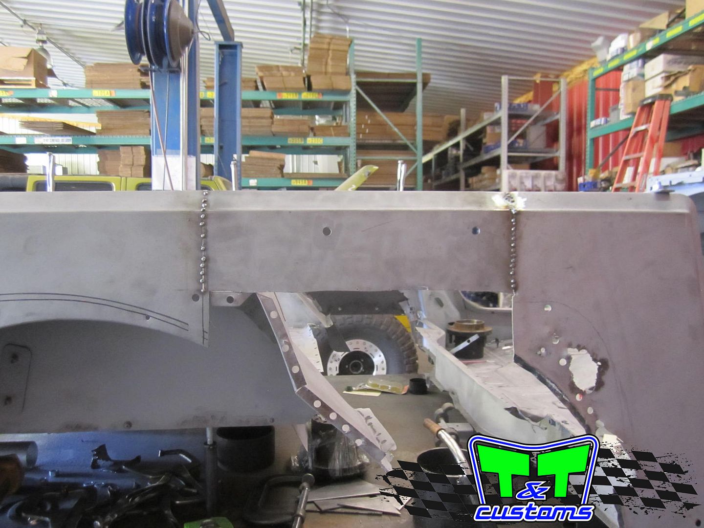

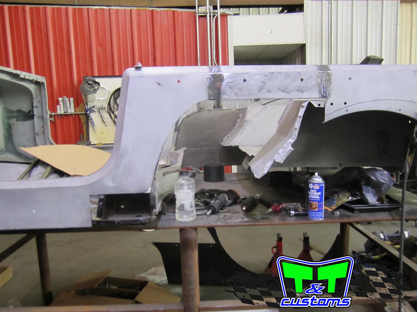

On to the drivers side
Had some rust along the rocker so it was repaired at the same time
Finally time to cut the new wheelwell
Pass. side

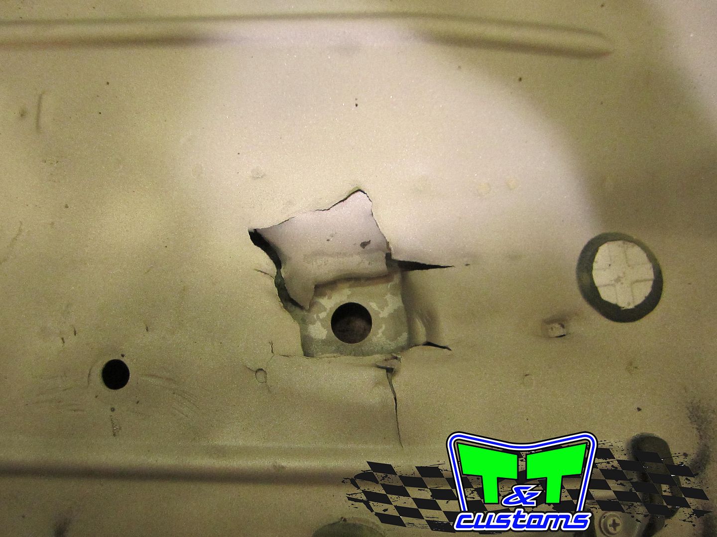

Next step was to start inserting the floor sections. We're going to do it in three pieces, an end piece in front of each wheel well then a center piece that will run between them.
End view of the end filler panel. I've got it upside down actually, the side that is pointed up will connect to where the factory floor board extends back several inches as well as to the center section piece. The front edge overlaps the factory floor while the rear runs under the wheel well. The side pointed down will connect to the side of the tub.
Here's the passenger side prepped.
Predrilled all the outer spot weld holes
Tacked in place
Fitting up the drivers side
Drivers side tacked in
Shot from underside
We should be able to get the center piece cut this week and hopefully installed next weekend.

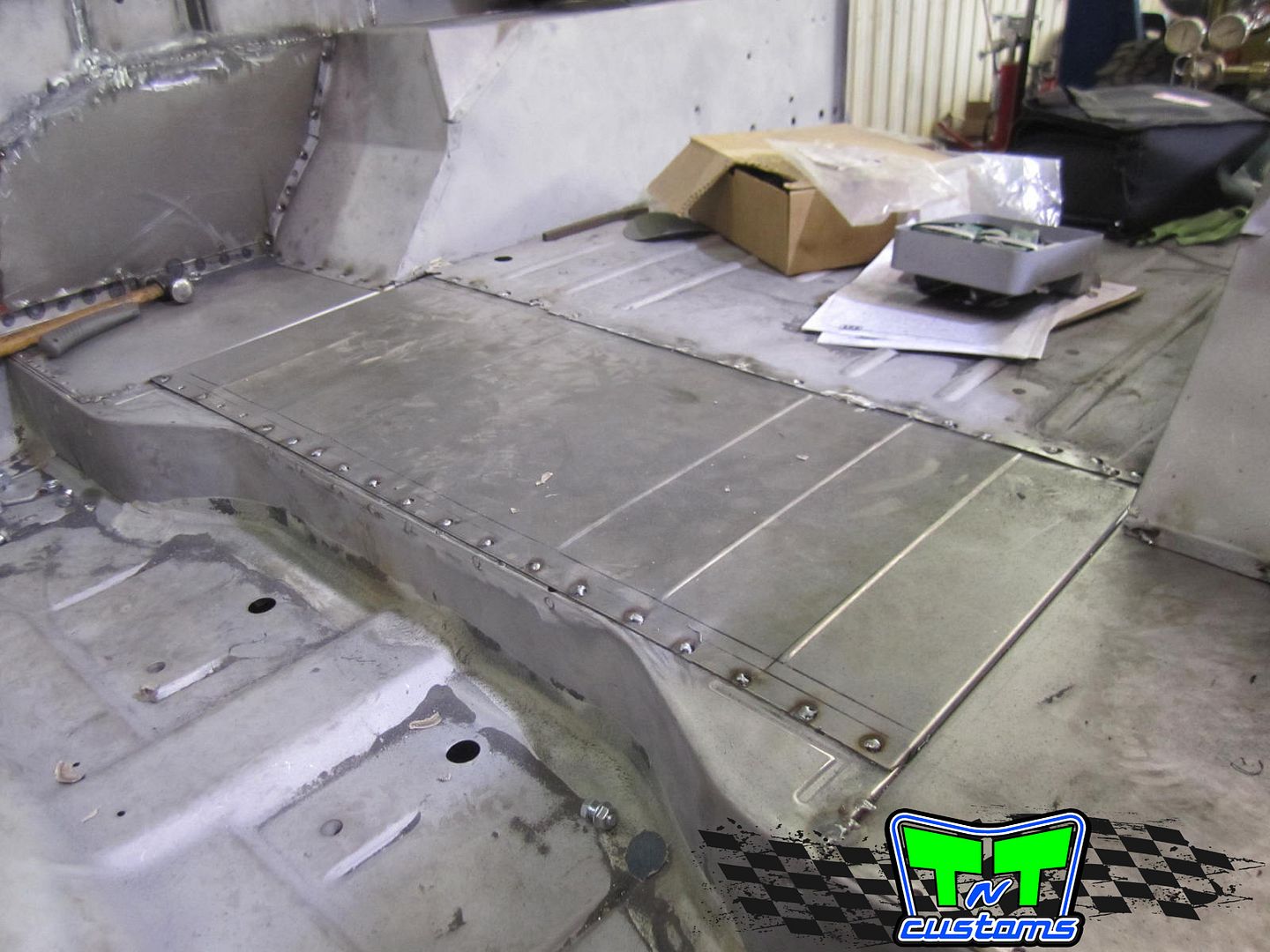

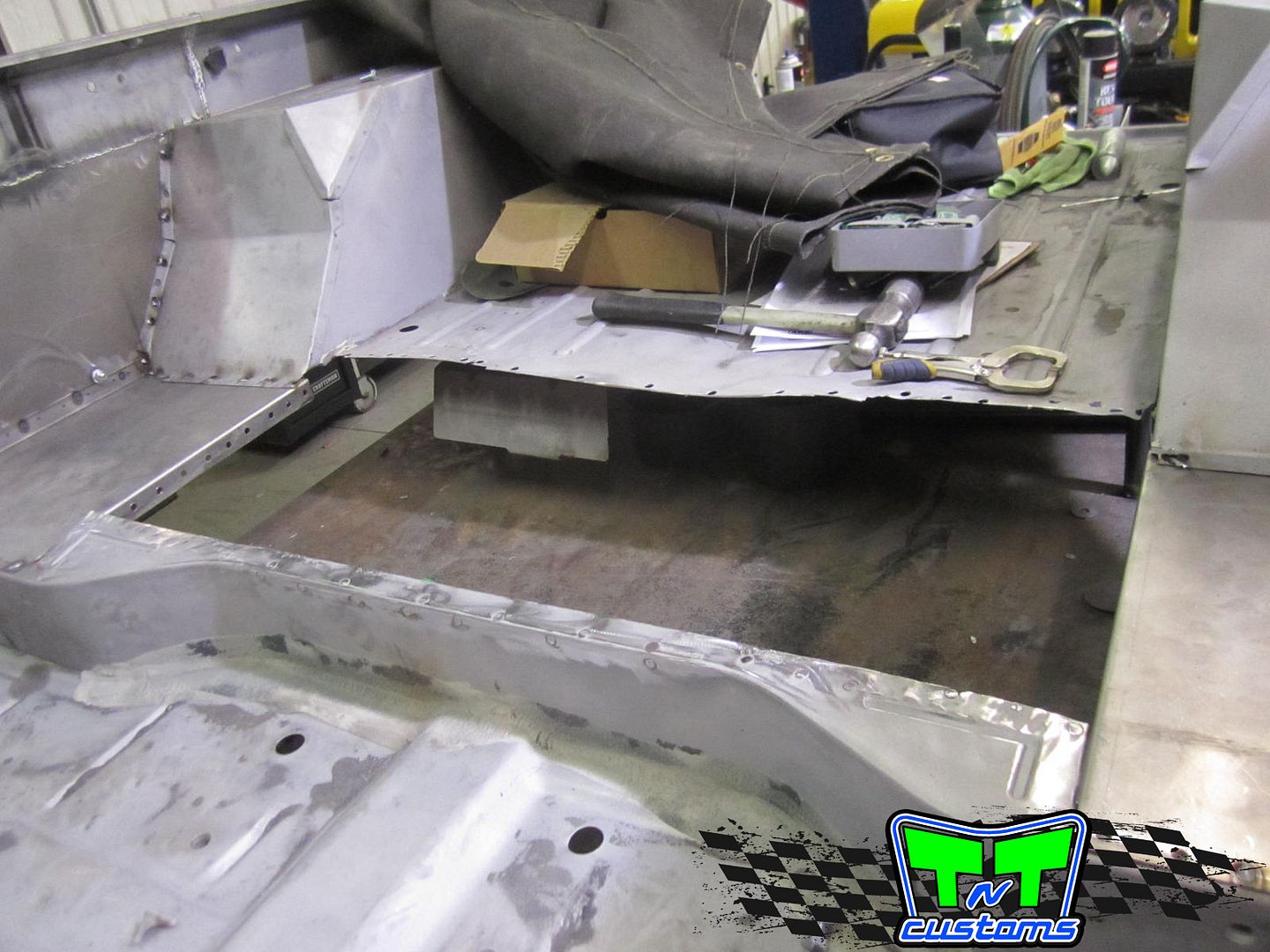

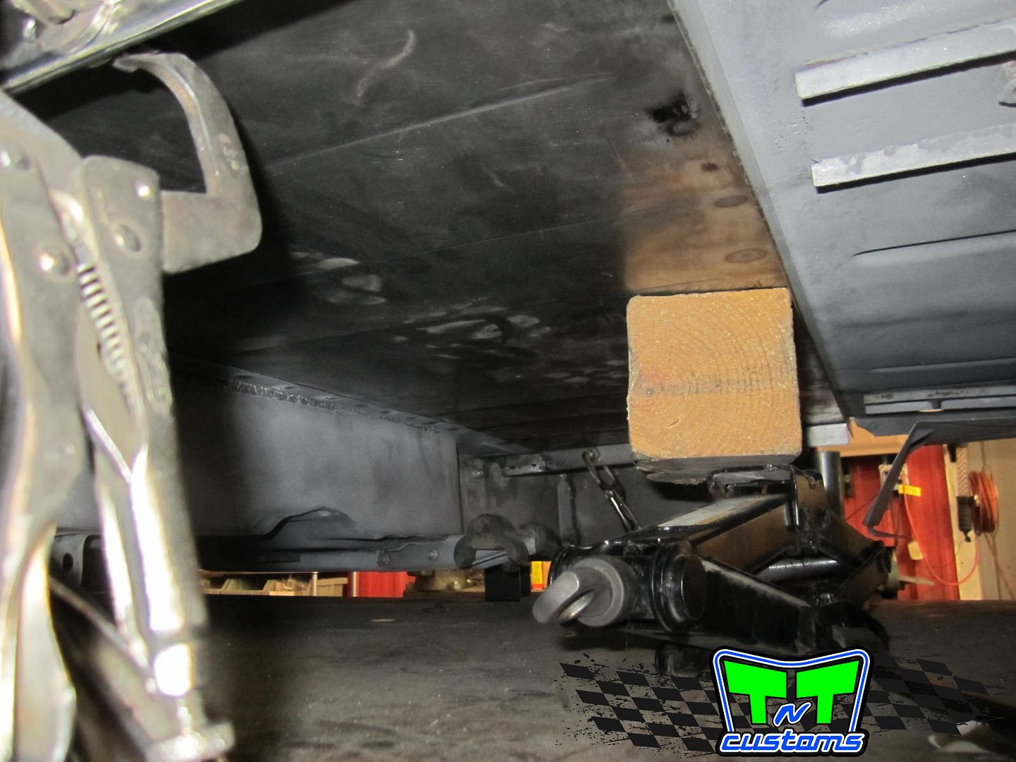

Time to fill the void
Got the floor piece cut this week. It's got a 1" flange along the back for strength as well as along the sides so I can spot weld it to the side pieces. We also rolled some beads in it to add additional rigidity.
Bob suggested I use a scissor jack to raise the back up tightly against the floor, this also gave me something to push down against so I could make sure the two pieces were tight together when spot welding them.
Welded in place. I was concerned I might run into a wrinkle considering how much we cut everything apart but it all went together nicely.
