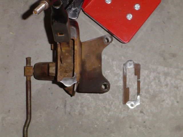

Thanks for the idea. I was ready to cut the z gate off and then I thought why don't I just take a dremmel tool and grind of the gate without removing the plate. I actually left about 1/8 inch of the stop in place so now I only have to very slightly move the shifter to the side to shift.

i swapped out a nv3550 and had to get a bracket from advance adapters to mount my t-case shifter and now that z-gate makes it even harder to shift. I may have to try this since I am about to have her down for an 8.8 swap.

works like a charm, diff.. idot proof hahahaha, drilled, hammered it out, came out quick.
wrks like a charm, thnxs again Max
