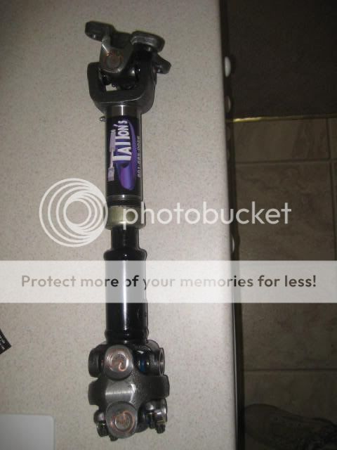

I just put a Tatton like this one on my Heep. Very nicely built and with a lifetime guarantee on the shaft/welds and unlike TW shafts, you don't have to use a certain u-joint to meet the warranty. The owner Curtis has an eBay store, but I called and gave him my measurements and details on lift, add ons etc. and he had it to my door in a week for $220 (incl. JF discount). VERY happy with it!
this is pretty much exactly what i am looking for. i have a front shaft being made from my old front shaft (i moved the motor 3" forward when i put in the 5.2). i am only looking for a rear shaft with the sye. i will defiantly look into the tatton shaft. what is the jf code?
