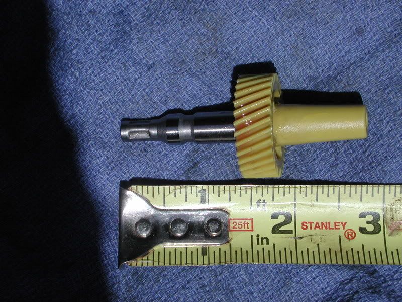

More On Clocking the Gear
So a further word on clocking the speedometer sending unit. The unit has numbers scribed around it, and slots for the retaining clip. I have a 33 tooth gear now, so it is clocked to the 32-38 range. With my previous 30 tooth,though, I found I had to clock it a bit beyond the 26-31 slot for the retaining tab for it to engage on the drive gear. You can tell whether or not the gear is engaged by whether or not your speedometer works when you do a test drive.
The speedometer gear itself--both the 30 and the 33 tooth gear are yellow, and on other tooth counts the color varies to correspond to the tooth count. The version in this photo is the "short" shaft version used on the electronic speedo sender in my 93. Earlier models used a cable drive and utilize the long-shaft speedometer gears.
