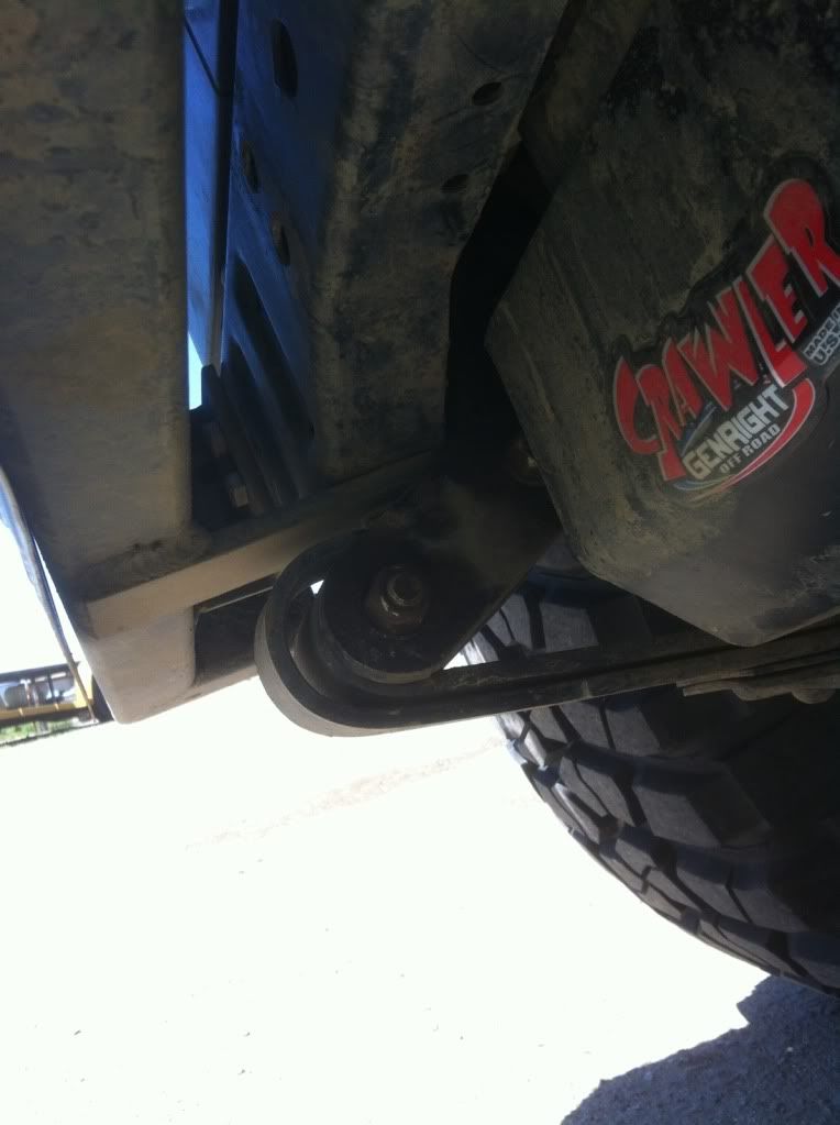

Should the small side go up or down? These pics show both. If I was Indiana Jones, I would choose small side down.

Small side up in the front and small side down in the rear. The pics of the crossmember being cleared by the shackles with mil wrap springs is the sole purpose for this in the rear. The front will prevent inversion.

That's the small side down in the rear.
