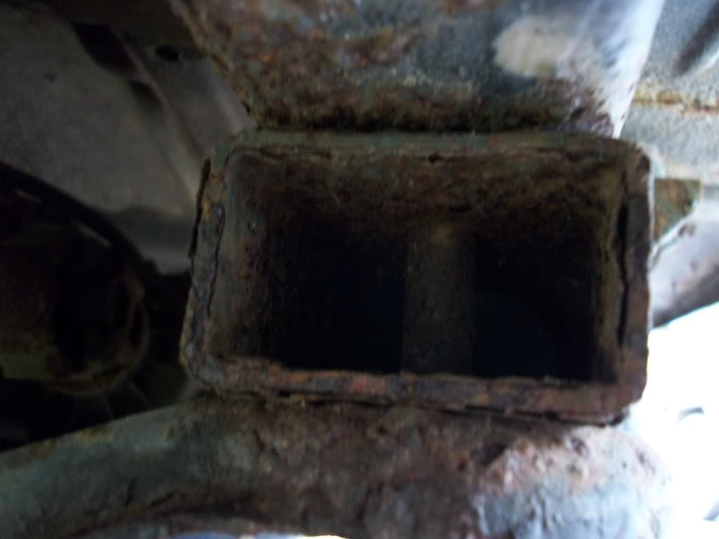

What's my best option to remove the bolts, without ruining the nutserts inside the frame.
Pictures of what I'm working with. The second picture is the spacer used to drop the skid plate.

Mine looked about like that. I figured they were going to be a ***** to remove so I heated them all up with the torch, then let it sit over night and with the pneumatic air gun they all came out pretty easily. I had also soaked them with PB Blaster for a couple days in advance. If I see any rusty bolts underneath, I spray it with blaster, even if Im not taking it out for any reason at the time. Seems to help retard the rust till I can remove it, wire brush it, reinstall it, and paint it. Or replace it if not grade 8 or stainless.

It looks like the Allen Head is stripped so there's not much you can do.
Here is what I would do:
Drill a small holes in the frame right next to where the nutserts are and start spaying PB Blaster on them.
Go invest in a good quality drill bit (if you don't already have one) and drill the head off that Allen bolt.
Since you have the drop kit you will have plenty of bolt left to work with once the skid plate is removed. Grind two flat spots on opposite sides of each bolt so your vice grips will hold without slipping and give that a try. Maybe add some heat.
If that doesn't work I would weld a nut onto each bolt and get them off with a socket and breaker bar.
The longer you treat the nutserts with PB the better your chances of getting them out without stripping/breaking them.

Weld a nut to the head of that sucker or get ready to drill for a long time.
based on that rust, you should fully expect to break off your nut inserts, you should really plan on it happening.

Unfortunately I don't have a welder, so I can't go the easy way and just tac on a nut, or that's what i would have tried. Also why I hope the nutserts don't break off. If i go about drilling out the bolt head what size bit would I need?

use a bit smaller than the bolt head. but no so small it breaks easy. sometimes the heat/pressure relief of drilling will get the bolt out and save the thread. good luck, I hope it works out.

I would start with a bit slightly larger in diameter to the hole and keep going up in size until you fully drill the head off. This way you wont dull the ****e out of a bit. Buy a good set of Dewalt bits and go to town with it.

I think he meant start with a bit slightly smaller in diameter...

I think he meant the Allen keyed hole on the bolt. It's easy to use as a pilot hole. It's just like torx, already centerpunched to be drilled out. I would PB the guy, then take a hammer and give it one good rap to loosen the rust situation and PB some more until you can get drill the heads off. Then grinder and vice grips as aforementioned. Then I would replace with convex washers and hex head bolts.

I started on them today. for the hell of it I tried the other side I didn't strip yet( yet being the the key word) with the allen key and was able to get two out with little trouble, but rounded out the other one.
The only problem now is I don't have a drill with a big enough chuck.

Don't be surprised, but from the looks of that rust, once you get it off you may have rusted holes in the frame. Mine did, I had to cut it out the rusted section and repair the frame.
