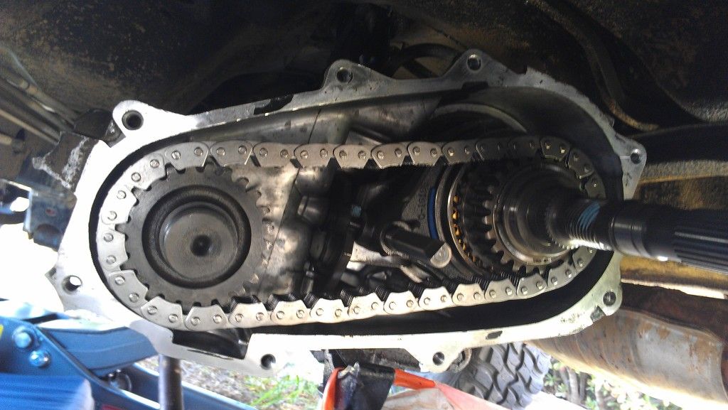

Here's new chain installed in my np231 from Napa, ~$70
did it right on the jeep. Since you're auto, be sure to put the tranny in neutral, I had hard time putting on one of the snap on rings and couldn't figure out what was causing it to not line up.
