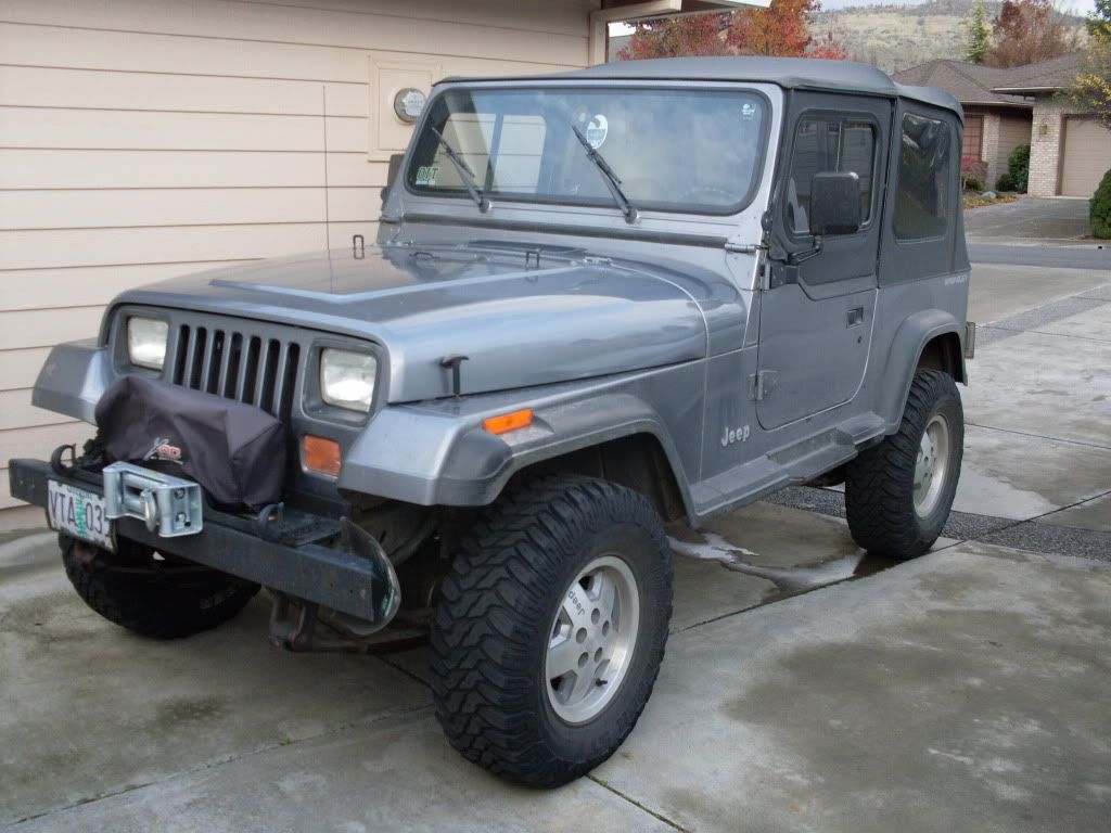

First Off, when I acquired the jeep in spring of 08 the first thing I did was put on a 4wd hardware 2 inch suspension lift. This was how it sat after that. Sorry no prior pictures.

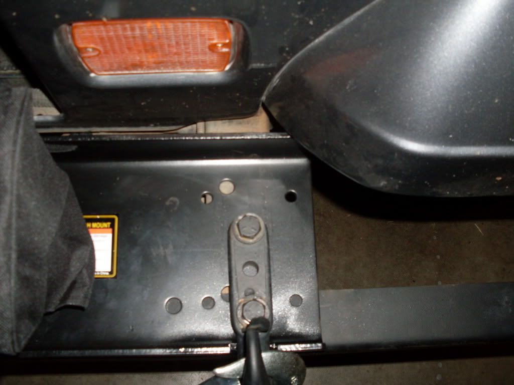

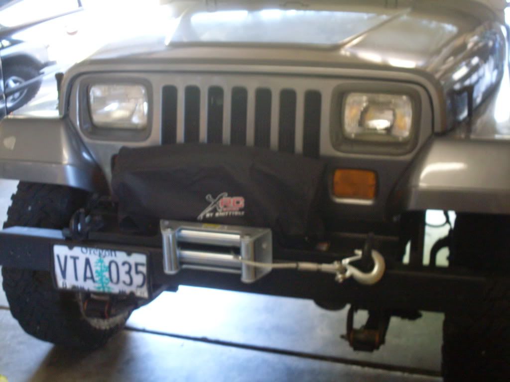

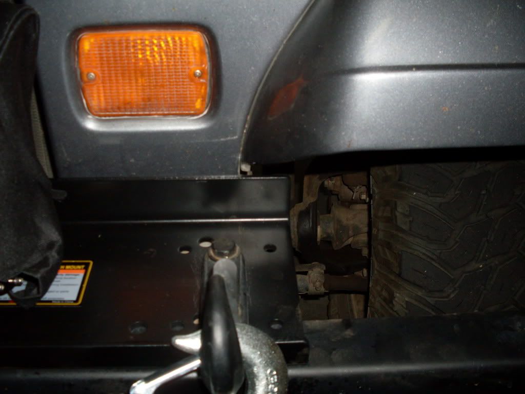

Next step was to get a winch. I went with the smittybilt Xrc 8000lb winch. I mounted it to the harbor freight winch plate. The only modification I had to do was cut two notches for the factory tow hooks. I was able to mount the plate with these bolts and retain the hooks.
Here it is all finished
Here are the notches I cut
[IMG][/IMG]

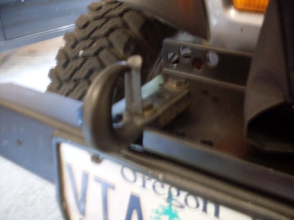

Here is how far past the frame rails the plate went. It is only about an inch so I decided it was easier not to cut it. It doesn't bother me so that is how it will stay for good.
[IMG][/IMG]
Finally, here is how much room there was between fenders and the back lip of the plate.

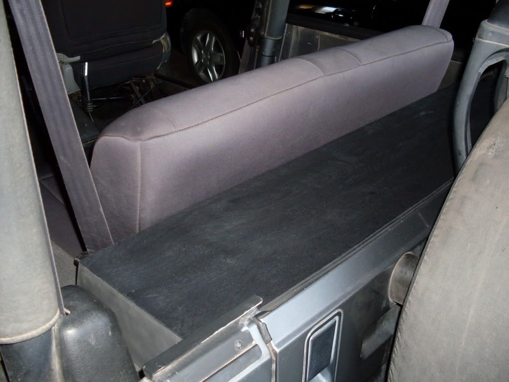

I get many questions about my speaker setup so here it all is.
Pioneer deck about $140 for christmas in '06'
[IMG][/IMG]
New Speakers for Christmas in '09' here is the front installed. BTW these are a pain to get to. Involves folding the windshield down and unbolting the entire dash. $50 for front pair.
Here is my homemade soundbar. It is made out of Pine, then wrapped in Vinyl which I sewed on my moms machine. The light was $8, supplies for soundbar totaled $30, and speakers cost $100. The speakers were my same present for christmas in '09'
[IMG][/IMG]

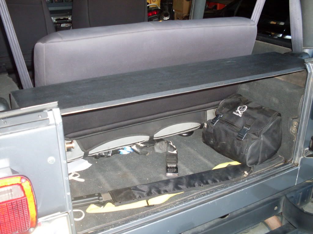

Finally a couple odds and ends. I created a trunk box for when the top is off in the summer
[IMG][/IMG]
[IMG][/IMG]

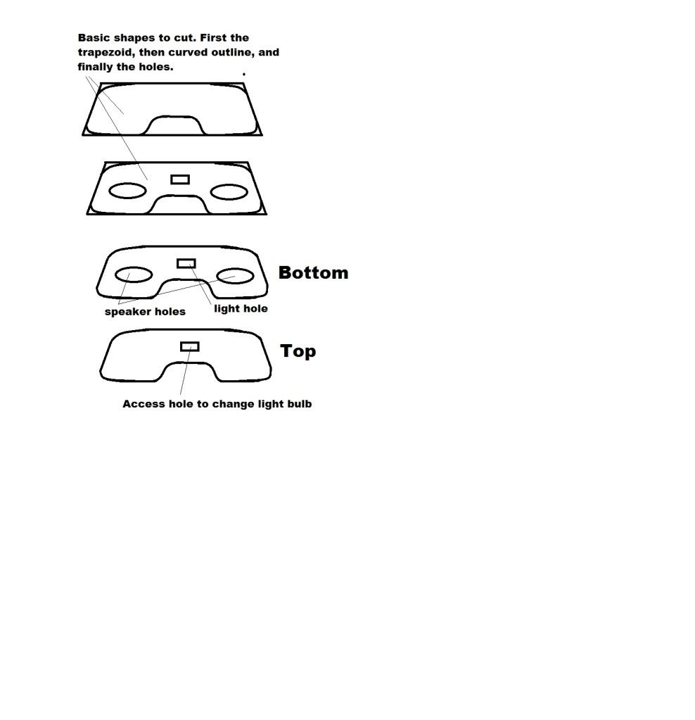

Anyways, here is a little diagram I put together. As far as measurements I couldn't tell you because I just went out to the jeep and started longer then I needed. I continued to cut down until it fit like i wanted it. As far as material I went to Home Depot and bought a 12" wide (measures out to 11 1/4") by whatever length needed (probably at least 8 feet) and 1 inch thick (which measures out to 3/4" thick) pine board. Be sure to sort through the wood and look down it. It can't have any bows or twists in it.
If this diagram doesn't make sense sorry, I could see if I could come up with something better so let me know. Also, measurements really depend on your speakers and what you think looks good.
Good Luck
By the way, that diagram doesn't show that I also cut holes in the top of the soundbar too allow the magnets room without making to thick of a soundbar. I realize this hurts the sound quality, but it still sounds great so I'm not too concerned. Also, I didn't cover the top since I have a full bikini top in the summer. it is covered year round and you can't see it anyways.
