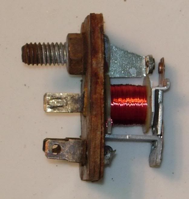

Trying to reduce some wiring from a HEI upgrade... What does this green wire on the top left of the starter relay or starter solenoid do/operate? It ran into 2-4 other wires in the wiring harness that went to the distributor/alternator. It is unhooked right now and does not seem to affect anything at all.....

i can't really see it too good in those pics. it's somewhat confusing what goes where....
here's the deal from what i know... and i've dealt with that relay A LOT...
big stud goes from alternator to battery.
dark green w/white stripe goes to your starter solenoid.
black is a ground wire i think.
and the 3rd, if i remember right, is the trigger wire when you turn the key to the start position.
if you buy a new replacement from the dealer today it will have a 4th wire that if i remember right and its a ground wire.

Hmmm.....I have an extra tab on mine next to the big stud.. (1988 with 4.2 liter) What the h*** can it be???

hummmm
this is from an 89 2.5
i ASSumed they were all the same.... guess not
what kind of problem are you having?

Mine has the extra stub as well. Can't remember where it goes ATM... I can check later.

Just wondering if this wire/connection goes to something critical... I did the 2100/HEI upgrades and have a few scraps to clean up...

it's your starter relay, but it's not THAT important...
I mean, you could always push start your jeep, assuming it's a manual.....

yea mine had the extra stub on it to but the new one i have only has three an the big stud WTH.
