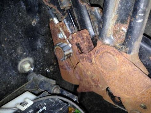

post #30 of 31 Old 07-05-2013, 02:26 PM Thread Starter
Tblair23221
Location: Nashville
Posts: 43
So I found the correct ground wire which was tucked behind the ebrake mounting bolt and verified it by grounding it and ungrounding it and seeing the gas gauge spike and then drop. I cleaned up the surface, bolt, washer, and ground wires eye but it still does not seem to be properly grounded. It will run for a bit and then stall with a spiked gas gauge, I can wiggle the wire and mounting point a bit and it fixes the ground. My question is can the amount of rust I am seeing on the ebrake assembly be causing part of the ground problem as well. It is pretty rusted up.
