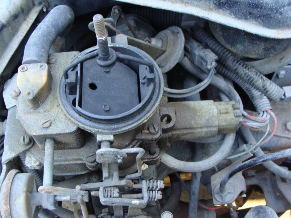

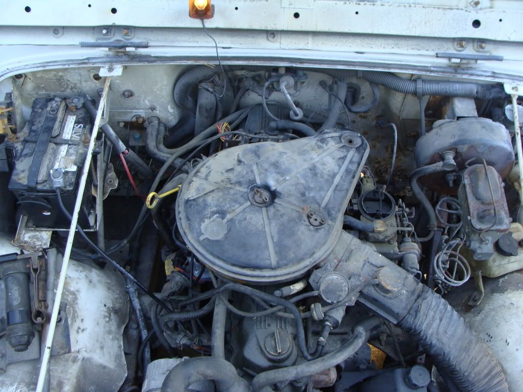

Okay, sounds like you probably have a 4.2 with a carter BBD. Just FYI, here is a link with some good 4.0 pics:

and here is what my 4.2 looked like with a carter on it:
http://www.jeepforum.com/forum/f12/p...-setup-857588/
Yeah looks just like mine

Something I just noticed, the choke plate is a bit different on mine.. it's more open...
