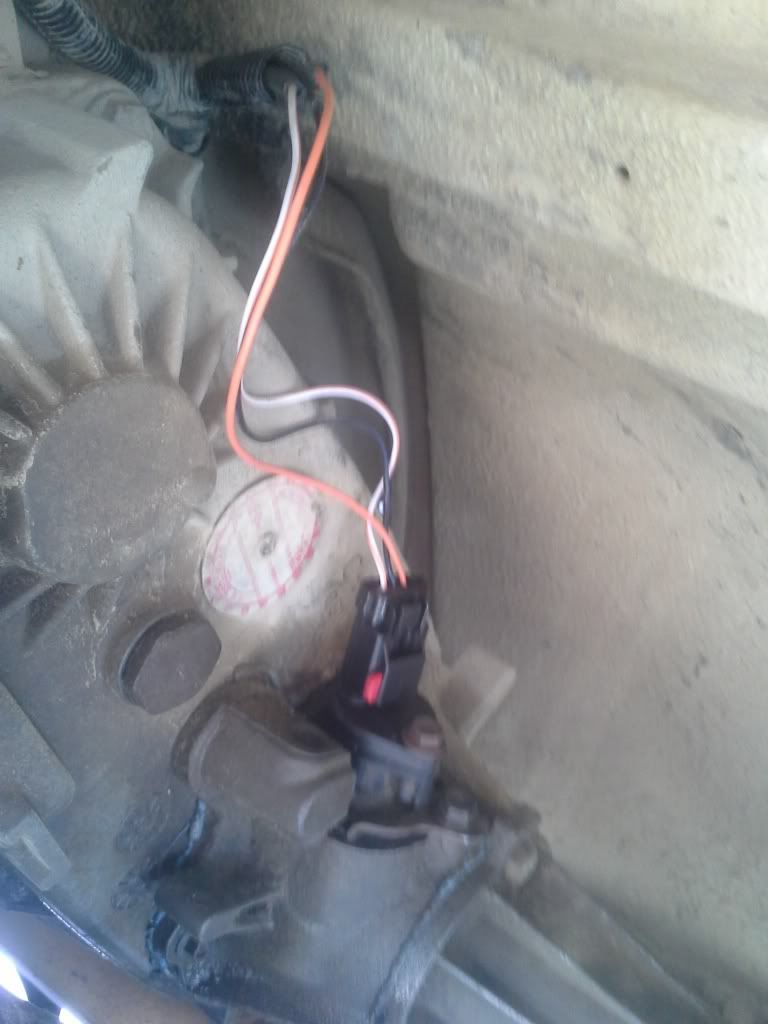

It's probably your speedometer sensor on your t case. Just replaced mine today.
Would you tell me what each of the wires does? I know one is hot, one is ground, and one is signal. But which is which?
nerdly is offline
post #8 of 8 Old 09-17-2013, 09:35 PM
ashland82391
Location: Chandler
Posts: 7,977
I have no idea. I just matched color to color and it worked.
