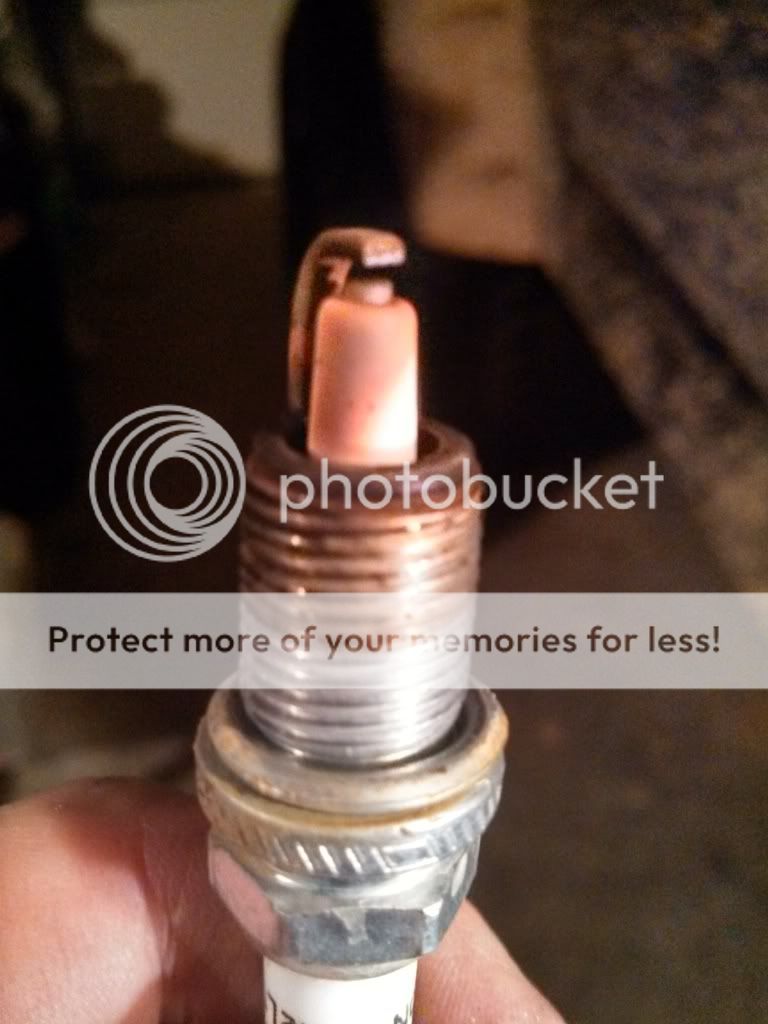

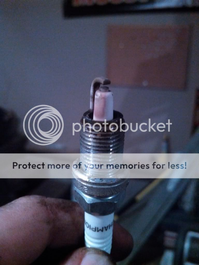

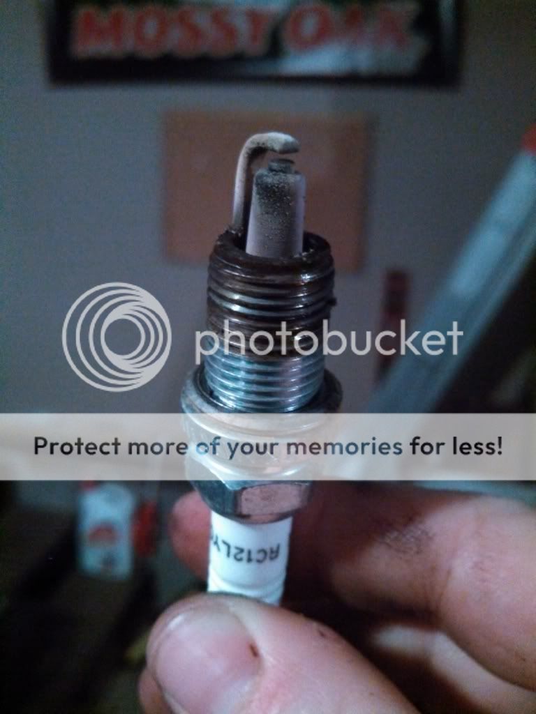

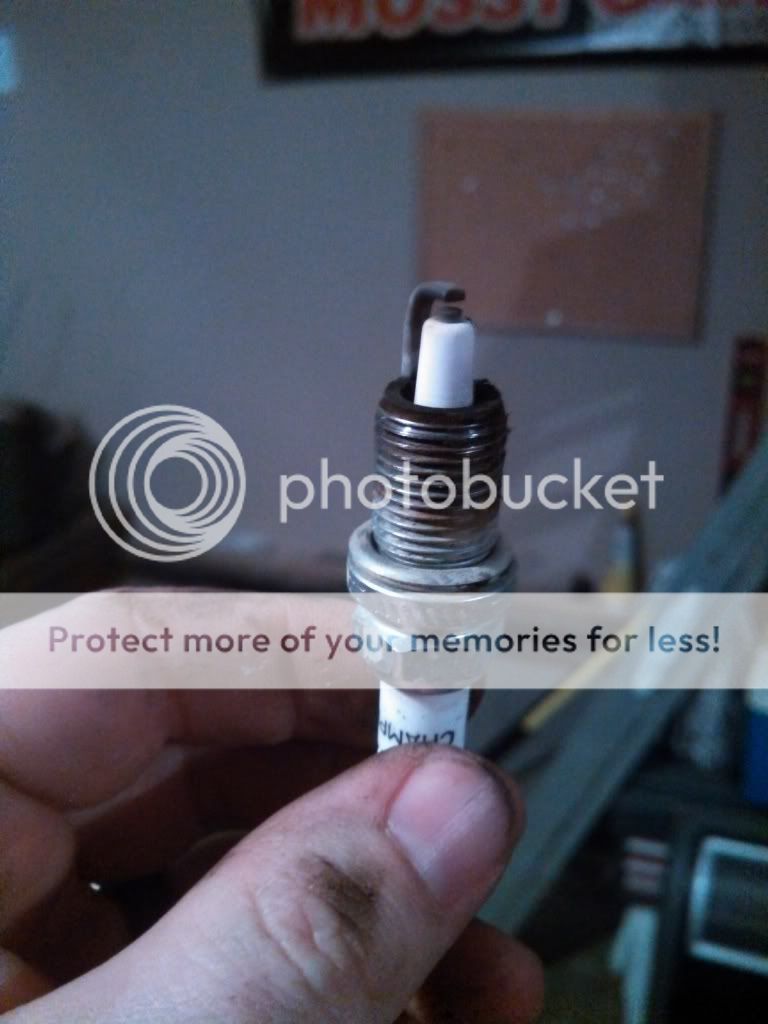

I know my 93 yj is close to 21 years old and the original 2.5 runs fine for its age but if it can run better why not. The following pucs are of spark plugs with approximately 2k miles on them. They are in order from the radiator to the tub ( front to back). Do they look normal...any issues? Thanks.

That one looks like its getting hot spotted.

The ones on the ends look normal. The second one looks kind of burnt. And I don't understand the third one where the ceramic looks bright white.

Compare your plugs to the chart they are actually not drastically bad. 1/4 look fine 2 needs a look and three should match a picture with a good description.

1 and 4 look normal, 2 looks like carbon build up but could be oil. Is it greasy or dry? #3 is a tough one. It looks like it hasn't been firing at all or is being washed with raw gas. Check the intake runners and wires on 2 and 3 something is up with them.

I should have stated in the first post I also replaced and used all new wires to the plugs. 2 is dry and I believe it to be carbon. 3 was not in near as tight but that is odd since I put them in myself and it was tight...not sure how it loosened up.

new wires don't always garauntee good.
manufacturing defects, installation oopses. Many things can mess it up.
Did you clean the threads in the block before you put in the new plugs? could have had crud that made the plug feel seated firmly but loosened up after running a little while.
