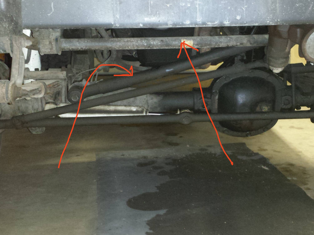

Hey guys so a few days ago I got into a bit of a crash.
The guy hit my front driver tire and now when I drive the Jeep it kind of pulls me to one side. If I hit a bump the Jeep really pulls and goes kind of out of control. Sometimes though if I'm going straight it doesn't pull at all and feels normal, but it just feels sort of random, unless it's a bump, then it feels pretty bad.
I was looking under the car to see if I could find any obvious bends, and the only thing I could really see is my Track Bar being slightly bent (but I think it's supposed to be kind of bent?), it also has a scratch going through it, which is why I think it could be that.
Other than that I don't see anything obvious. You guys have any ideas what it could be?
I'll leave a picture to show what I see and I'll take more if you guys need, but I don't think the pictures will help very much if can't even tell in person.
Also my power steering pump is leaking from the bottom, especially when the tires are turned all the way to the right, which is why my axle is all wet.
I think I had this from before but maybe it became worse?

Jack it up and see if there's slop in the assembly by pushing-pulling the tire at different points. The impact might have trashed your hub or a ball joint. I wouldn't think it would be a tie rod end, but I wouldn't rule out that possibility either.

Pretty much a full inspection, wheel bearing, ball joints, tie rod joints, might measure the C to be safe, track bar, bushings, steering box and mount. If it moves or is part of the steering it needs to be checked.

Take a pic from way back and then zoom in to get the whole front axle. that eliminates the distortion from the wide angle lens.
Best to take it to an alignment shop for a check on their machine. Ive seen where the rear of one spring leaf and the hanger bent ever so slightly and caused the same random steering.
It depends on the direction and location of the hit as to where the greatest force and weakest link intersect.

Yes, your track bar is scratched and must be removed. You'll thank me later.

Also, follow Dred's advice - if he hit your tire (from what i understood) alignment, ball joints, and hubs should be inspected - like soon, like now. DOn't let this go because its 'random' and sometimes 'its fine'. You're experiencing some bumpsteer, and that can turn into a real panic situation if you let it slide.
CHeck back with us and let us know what was found to be the culprit(s) (i think its going to be greater than one)

It looks like the drivers side tie rod arm of the knuckle is twisted and the tapered stud is now tipping outward. Jack the front up to take weight off the wheels and have you biggest gorilla of a friend try to rip the wheels off while you wrap your hand around every joint feeling for loose movement.
I'd still put it on a machine after replacing any loose hardware.

Just be to sure, are you talking about this part:
Gozz is offline
Yes.
And while you're under there, let's get rid of these items as well, shall we?

That's not going to fix his problem. Probably make it worse till its fixed.
Yes, That's what I was seeing.

He said its bent. And it's useless. And heavy. And it's ugly. Besides, how many SOA guys are running either or both of those items? Drag link angle is high to me and he's describing bump steer.
OP, did you get a chance to check your wheel for play in the 9-3 o'clock and the 12-6 positions?
$500 is a lot of money for an item to be rebuilt when new can be had for much less without being a huge mechanical challenge. What were the other items you were referencing that were also going to be addressed at that estimate?
As for it probably needing an alignment, it probably does. Also an easy fix that you can do yourself.

You need to find a different mechanic, that drivers side knuckle is bent/twisted where the tie rods attaches, it should be vertical..... At the very least you are looking at a new knuckle and tie rod end but I would bet one or both ball joints is shot as well as the wheel bearing.
