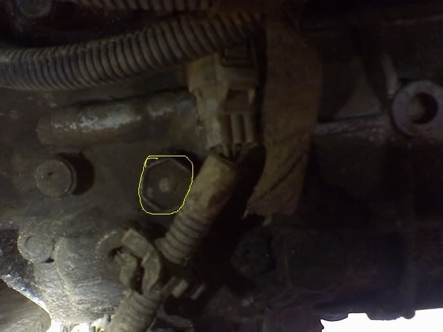

It is not torx on the fill of the ax5 if thats what trans you have. do not remove it!! Its a hex sae sized bolt on the passenger side about midway from top to bottom and more towards the back. Ill post a pic of what it looks like tomorrow after work I just got done flushing my trans and transfer case tonight and cant remember the size of the bolt but I will post the size and a pic of the location tomorrow.

the bolt with the dot in the middle is it

They all look like they have "dots" - laugh
This one?

You gott'er

Don't take out the Torx plug on the driver's side. It is not the fill plug and if you look closely you will see that the Torx plug has "Don't Remove" or something like that printed on it. I have no idea as to what it is for. As the others said, the fill plug is on the other side, 15/16, with a dot in the center.
Don't ask how I know about this plug but I was lucky as it has been a few years with no fallout.
