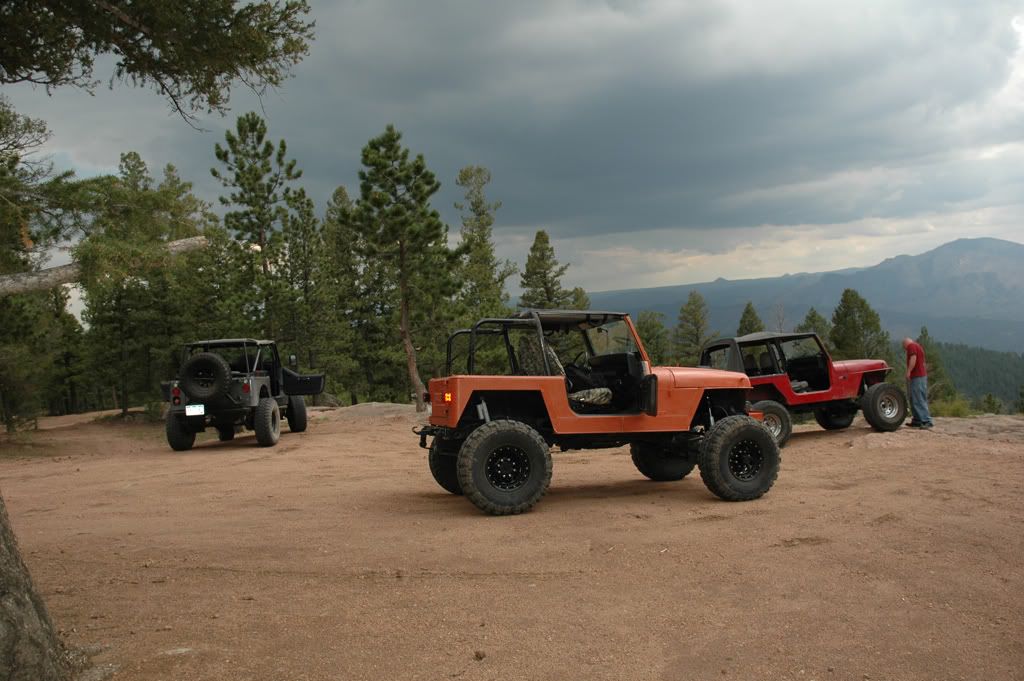

In the pic my jeep(orange) Soa on 1.5 in lift springs, red jeep is soa on saggy stock springs, and the grey jeep is sua on re 4.5 in lift springs.

wow thanks stinger, awesome pic, i'll probabaly just go SUA for now to save some money, but thats not to say i won't always stay SUA, is there any real advantage (besides cheap lift), to go SOA? either way i'll need new springs eventually, so seems to me not having to make or buy an antiwrap bar and worryin about more stuff breakin and the money it wail save me now (laid off college student), i might as well stay SUA.
